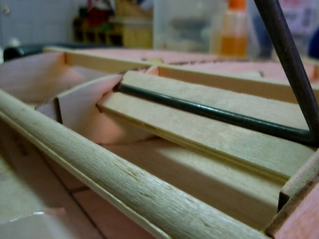

Default RE: Trike to Tail Dragger Conversion - Tiger 60
Heres what Im doing.
Im about 1/2 done with the fitting.
