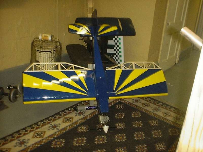

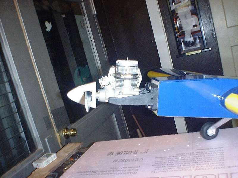

This is my 60 size uproar with a webra speed .91 Does anybody know a good prop size to use on this setup ?? I want to be able to have good vert. with power to spare!!! I did make the rudder 1" bigger to help with 3d flyin. thank.s Bill

Billium I believe you done gone past overkill. The uproar is a 3-d style plane. with that engine you probably will end up tearing the airframe apart. I would suggest using a smaller engine. And Webra engines are kinda on the hot side anyway. If you must use this engine go with the biggest diameter and lowest pitch prop you can. I have not used one of those engines. So exact sizes I will not pontificate on. But check your owners papers. There should be a good starting point. Just keep the pitch down so as to not over speed it.

With anything smaller than a 90, this plane is a wimp. I'm using a ST 91 on mine - tried a ST 61 and it was much too small. I think I'm using a 13-6 but not sure. Do search and i think you'll find that most have gone to a 90.
