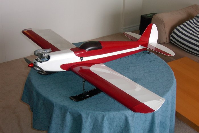

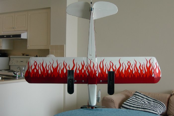

I have used Super Sportster 40 (it builds exactly the same as it's bigger brother). Due to a freak incident a few years ago, I had to completely rebuild the wing from scratch. I had only ARF experience at the time, so I consider it my first build also. I did it without a jig. It's a constant chord wing, which makes it very easy to build. The fully symmetrical airfoil doesn't make it difficult. Just build it like the instructions say and you'll be okay.
