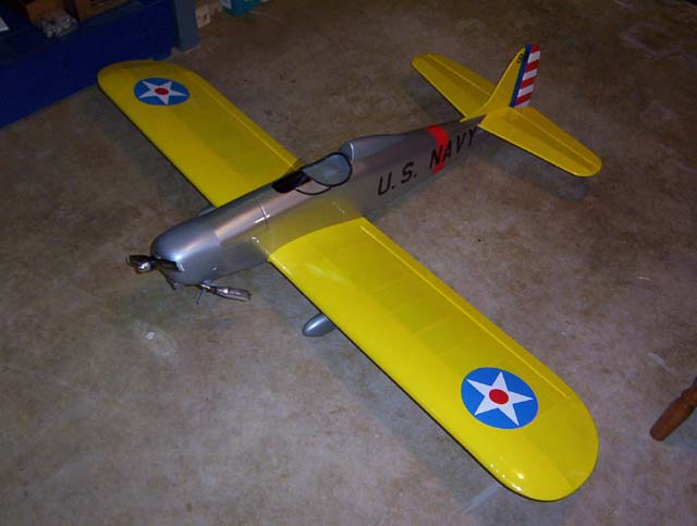

I've been thinking of building Sigs famous Astro Hog and checked through the threads because I was looking to make some modifications and seeking ideas. I saw a couple of pics of changes made by some creative builders. However, I would like to see if there are any other changes some of you have made to update the Hog. Pictures would really be appreciated.
Thanks - Tony

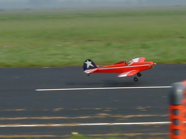

No pictures but I have put electric motors in astro hogs. I have done it with great results. (Sold one) I have used brushed and brushless motors. I scratch built one 3/4 size from the original. Flew just like the big one. On my first Astro hog I had flaperons but not on the others. It took off in 10 feet and I had a hard time controling it at that slow speed! Not needed to land either. The Hog I made from the first kit weighed 9 1/4 pounds.

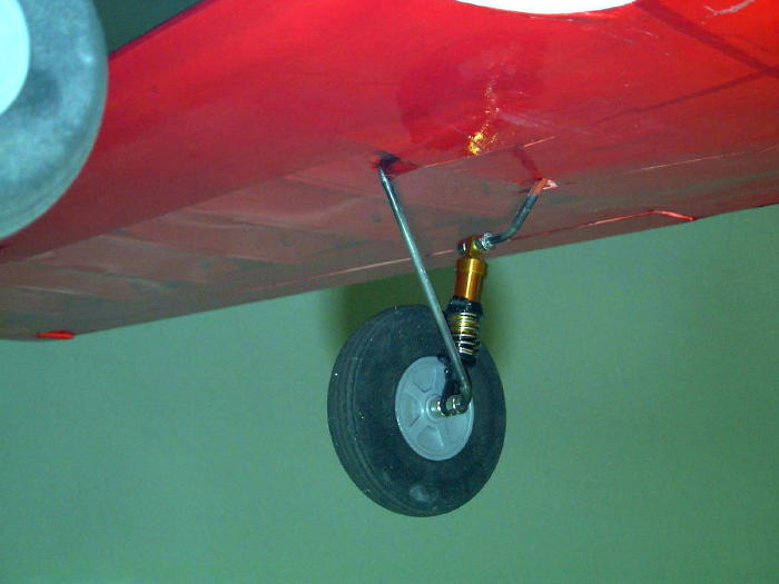

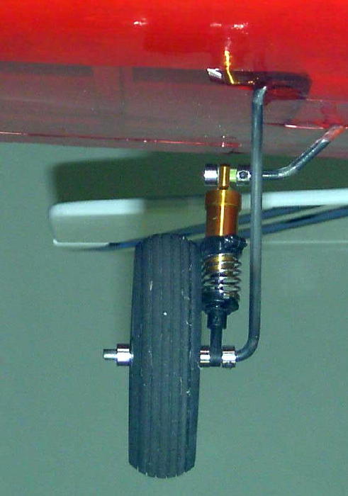

I put shock absorbing landing gear on one of these. I used R/C car shocks. I have used these on a Tigerkitten and a Super Kaos. Takes all the bounce out of landings. I need all the help I can get.

Thanks to all for your suggestions and looking for any others as well. I may get into electrics in the future but will stick with modifying the present kit version. Salmonbug, I've read a few threads about using a .91 four stoke on the plane because it can turn out on the heavy side. Do you think this would be too much engine?
Jim, I like the gear mod, it's great. I think I just saw it in the current copy of Model Airplane News, was that your suggestion?

Yes that was my contribution in the MAN Mag. Got me a years free subscription!

Here is a pic of mine.The mods I made were ,composite landing gear moved to the fuse,less dihedral,wheel pants,bubble canopy,bigger rudder,and fiberglass cowl.

Spicoli, beautiful job!! Where did you get the gear, cowl and wheelpants?

I got the Klett landing gear and Goldberg Extra wheelpants [Aeroglass] from Great Hobbies in Canada.
The cowl I got from Fiberglass Specialties.

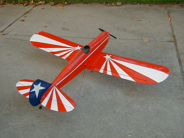

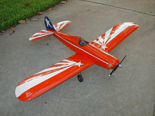

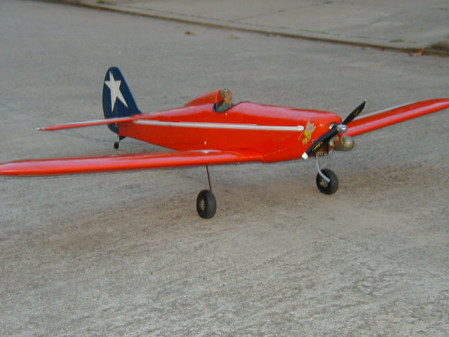

I decided to invert my engine and cowl it in. I shaped the cowl out of a block of balsa.
I think the tail feathers of the Hog look a bit dated, so I reshaped them, also! Actually, I borrowed a set of plans from the Sportster series, and scaled them to my Hog.
I've had it for over 15 years, and she still flies like a dream! I have an OS 60 in it, and she flies nice... no verticals, but do many full-scale planes???
