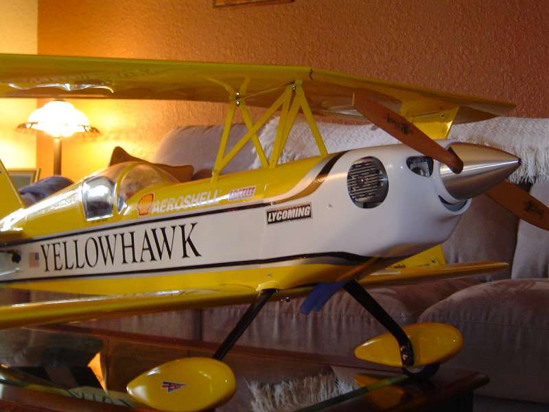

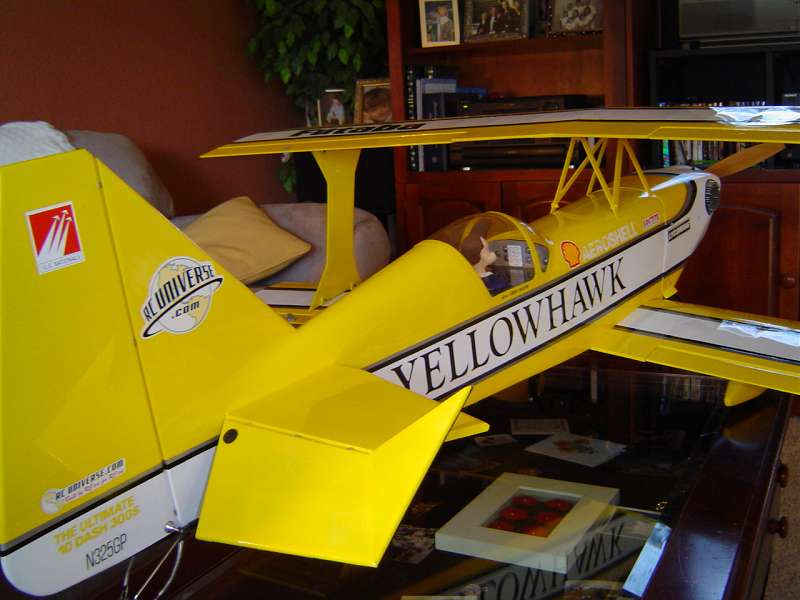

Joined: Apr 2003
Posts: 79
From: West Jordan, UT
Default RE: Goldberg Ultimate
I just finished my CG Ultimate and posted some pictures. I didn't do any mods. I used a Saito 100. Haven't flown it yet but it all came out straight and true. Scared to death to fly it.
