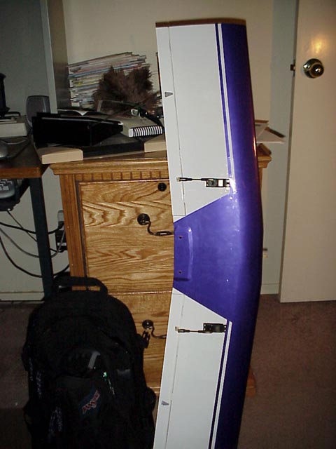

Default My GP Ultimate
I am just finishing my Ultimate and only made a few mods. The first of the mods was to change the bottom wing into a 2 servo setup. I did this because I did not like the idea of 2 torque rods and then 2 more linkages going up to the top wing. Sounded like a great combination for flutter. My second mod was to add a Pull-Pull setup for the rudder (Yet to be installed). Finally, I changed to tailwheel to a Ohio RC type (Can use a sullivan also). I did this because I have never liked the hinge type tail wheel setup.
I also put an O.S. .70 Surpass II up front
Cowl is from Stans Fibertech
Phil (Mesa, AZ)

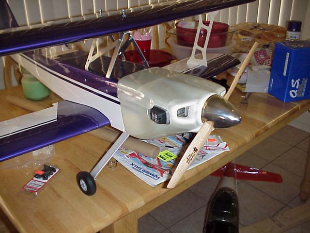

Old 06-16-2002 | 04:31 AM
SunDevilPilot's Avatar
Joined: May 2002
Posts: 2,025
From: Gilbert, AZ
Default Pic of the front of the plane
Just a shot of the cowl and some of the plane.
For more info on this plane I started a thread at this forum.
http://www.********.net/forums/showt...&threadid=2436

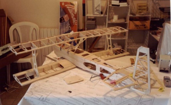

Hisham's Avatar
Posts: 905
From: Beirut, LEBANON
Default skeleton
needs some more work and will be done with
the wood works...
Old 06-27-2002 | 12:42 PM
Hisham's Avatar
Posts: 905
Default another one!
2nd pix
