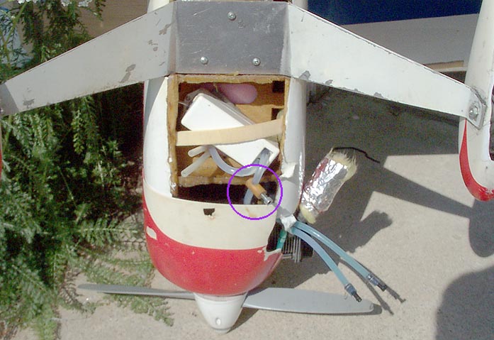

I just finished building the skybolt, and it's definatly not a beginner kit. LOTS of sanding...but it was really relaxing....I was in no hurry to finish it and it took me about 2 months to get it to the covering stage. I'm putting a Saito .91 in the nose, and Futaba 3001's everywhere. It sure is a pretty plane. Minnflyer, where did you locate the smoke system, which one did you use, and what would you recommend about installing it? Also, what size smoke tank did you use?

I've got the TME Simple Smoke Pump. 10 oz tank supplies plenty of smoke with the Ultrasmoke oil.
Old 07-16-2002 | 08:09 PM
MinnFlyer's Avatar
Posts: 28,519
Received 9 Likes on 9 Posts
From: Willmar, MN
Default GP Skybolt builders
The pump is located under the Tank Compartment. The oil tank is in the fuel compartment, and the fuel tank is behind the oil tank and extends into the fuse.

Did you install the smoke system when you were building the plane, or did you add it afterwards? I cringe at the idea of cutting into the fuse and damaging my beautiful plane.

I did it afterwards, but then, My plane is 10 years old, has had one side of both wings sheared off in a story titled "Dead stick landing meets the Sapling" and numerous tails of landing gear being ripped off. But you can easily do a little surgery and (being a little more careful that I was) make some nice hatches to access everything. I took some pics last night to show you how mine is...
Here's the smoke pump under the tank compartment...
(Note the homemade restrictor valve that I made)

Thank you for the pics...they will be invaluable if I decide to put smoke on mine. The wood in that area on the plane is pretty thick.....I believe I could make a hatch right there no problem.

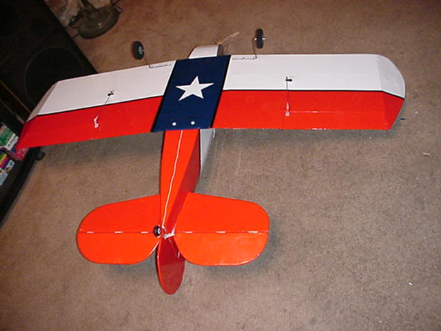

I am still working of the picture of the skybolt, but as a test, I am trying a pic of my texas slowpoke. Great movies of the skybolt in action and some great flying.

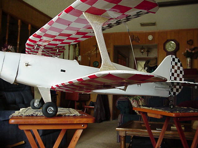

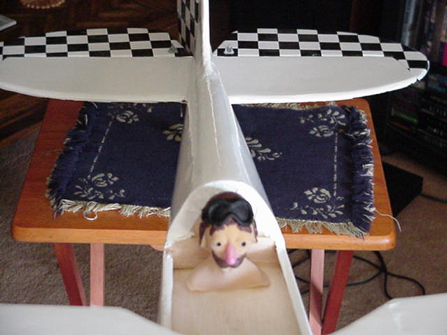

Ok Bear you asked for it, I haven't really settled on a color scheme but the tail and under wings are pretty well set, the rudder is a pull pull system the rear wheel is a spring assembly, and Captain Eddie is at the controls. Please forgive the mistakes and picture problems, I am very new to this forum. I'm sure you will let me know if I am going beyond prodocol.

second picture, can you post more than one at one time?

Old 07-18-2002 | 03:41 PM
MinnFlyer's Avatar
Posts: 28,519
From: Willmar, MN
Hey Bucco!
I hate to tell you, but you've got your landing gear on backwards!
