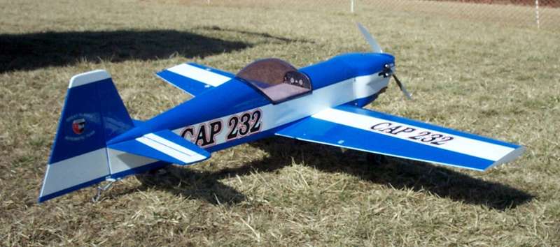

Good day.
I want to thank RCU for the great input from all the members on the construction of this kit.
With consideration of all the forums read, the kit had these changes.
Pull pull rudder, foam tires, mini servo on the throttle, dedicated servo ailerons, and a well used ST .60 for power.
Weight came out at 5 lbs. and the CG was right on! This was checked 12 times before I believed it.
I waited for my dad to see the maiden flight and of course there was a 12 mph wind by the time he got there. No complaints, it flew real stable and pretty. It would really rocket by you at full throttle and settle down nice for some real slow flybye's. With the elevator at suggested setting's the "cap snap" was minimal if not there at all.
Hopefully get some pics here.
All hail RCU, thanks again.
Spanky

Thanks, Dad liked it. He may try to get into it.
I would almost recommend this for a second kit/plane if someone has a ton of time on a trainer.
My first try at pics, so bare with me.

Flew it again today. It is real stable. I have a model tech 300 .30 size and this cap flys so much slower
it's hard to figure out the landing. When they say "the bigger-the easier" they arent kidding.
Here is a shot of the pull pull set up. It probably isn't the best but it works. The steel rods that are recommended
were replaced with the golden rod through the fuse to save weight. There is a high torque servo on the rudder
but I don't think one is needed. This plane will climb out on a knife edge at 3/4 throttle, even with the
rudder rates recommended. This .60 ST is sure tired, a hot .46 would probably work well.
Nice plane. The build was easy, especially for a man of my caliber. It showed MANY things to aid in
building a plane that I've never known. Like the amonia and water for sheeting.
Spanky
