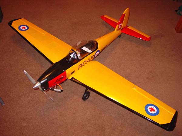

I finally put on my cowl on yesterday evening. It doesn't fit. I have a OS 46FX and I bought a bisson muffler's inverted straight muffler. As you probably know, the Chipmunk has a very narrow fuselage. Well, up front where the engine sits, it's only 9cm wide! that means that you have no choice but mount the engine inverted. In the end I had to cut out a fairly large hole out of the side of the cowl to get it to fit.
In the beginning I was fairly sure the hole would be very small, that only a small amount of the muffler had to stick out. But as time went on, I realsed I had to cut more and more to get the cowl to fit. Had I known before-hand that the bisson muffler would not fit I would have kept the original OS stock muffler. I think the hole in the cowl to clear the muffler would have been more aesthetically pleasing!
Anyway, I'll post some pictures this evening so you can see what I mean. Also, I think with a 4-stroke engine it would fit perfectly.

Here are the final pictures...
The worst part is that the gaping hole in the cowl would have been so much better had I just used the stock muffler with the OS 46FX. I initially thought the hole would be smaller, but I would try to fit the cowl.. then cut, try again, then cut some more....
In the end even the muffler's 'tube' didn't fit inside the cowl. It looks worse in the picture though.

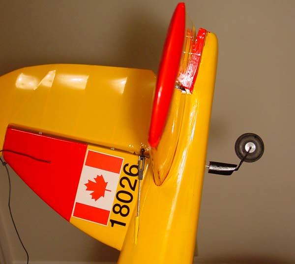

The chipmunk ended up bieng 8 pounds total. It flies really nice (only flew it once as of now), but I need to do some repairs. I built the tailwheel as in the instructions - not stearable. HUGE mistake. The plane immediately pulls to the left whenever I try taking off, and even a tiny breeze spins the plane, no amount of rudder corrects this tendency.
On the other hand, once in flight, the rudder has a huge amount of yaw, I suppose it's just a matter of getting enough airflow over the rudder. and when trying to taxi, the airflow just isn't there.
So now I have to figure out how to connect that tailwheel to the rudder.

If you can't make it turn with the rudder, try securing the tailwheel to a central position with springs or rubber bands. It will turn when you need it to, but will resist other inputs.

I believe the Goldberg would be an easier build. Airsail uses a lot of plastic parts that require painting. They alos like to use bellcranks in the wings. I did not, but used servos in each wing. I did not install flaps. It also is designed for a non-steerable tail wheel. Take a look at what I did. I have a rod going all the way through to the rubber.

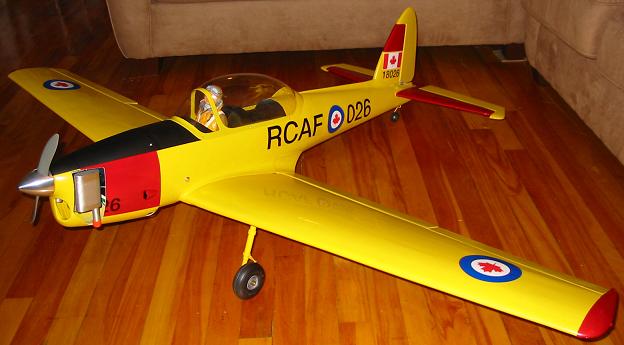

I finally got around to getting better pictures of my new Chipmunk. Now all I need to do is finish up the canopy frame painting, and a few other details before flying season hits....
