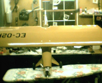

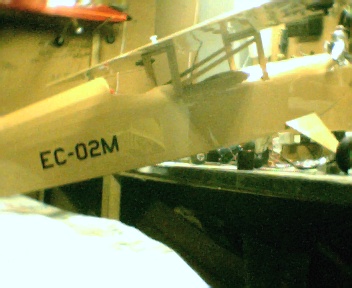

I also have one just about ready to cover. The only construction I have left to do is to set up the struts.
I still haven't figured out yet out to apply finish to the area around the struts. I can't see an easy way to do it with iron on covering after the struts are installed without having a lot of "cut" marks. I'm leaning towards covering this section of the fuse with silkspan, fill and then paint, although I may take the easy route and cover the fuse with iron on before installing the struts .... I would be interested to hear how others are doing this and if they are happy/not happy with the approach they took.

Regarding the covering around the struts. According to the manual, the model should be covered before installing the struts. That said, my plan is to apply stain to the struts and then apply poly urethane before gluing them into the fuse. Haven't done it yet, but that's my plan.

I covered my kit with Monokote before installing the struts. I just painted the exposed part of the struts with fuel-proof paint and then gave them a coat of clear Lusterkote. They look fine and have held up well. Make sure you get an incidence meter to set the wing incidence. It's easy to do by shimming the top of the struts.

just finished mine, I thought it was kinda a pain too, but its very pleasing to look at once its covered, you just dont see parasol planes that much. If this works here are some pics i took as i was covering.
