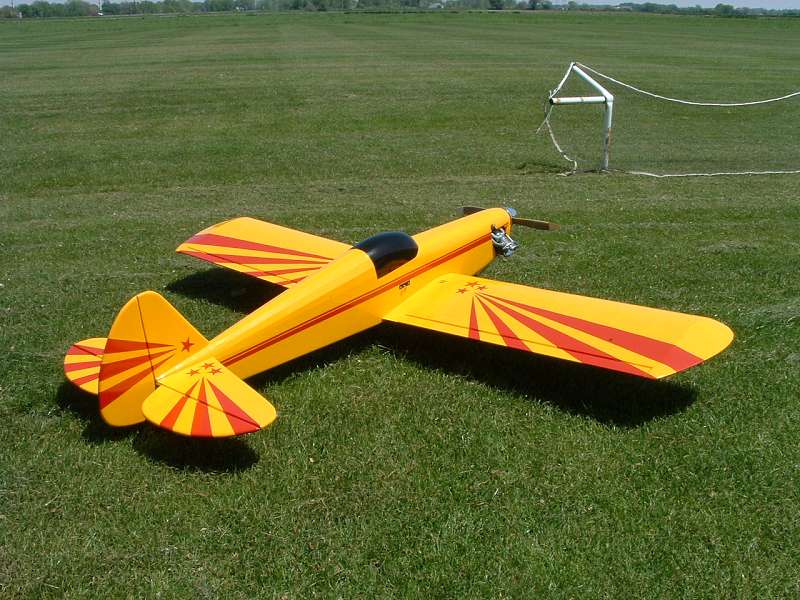

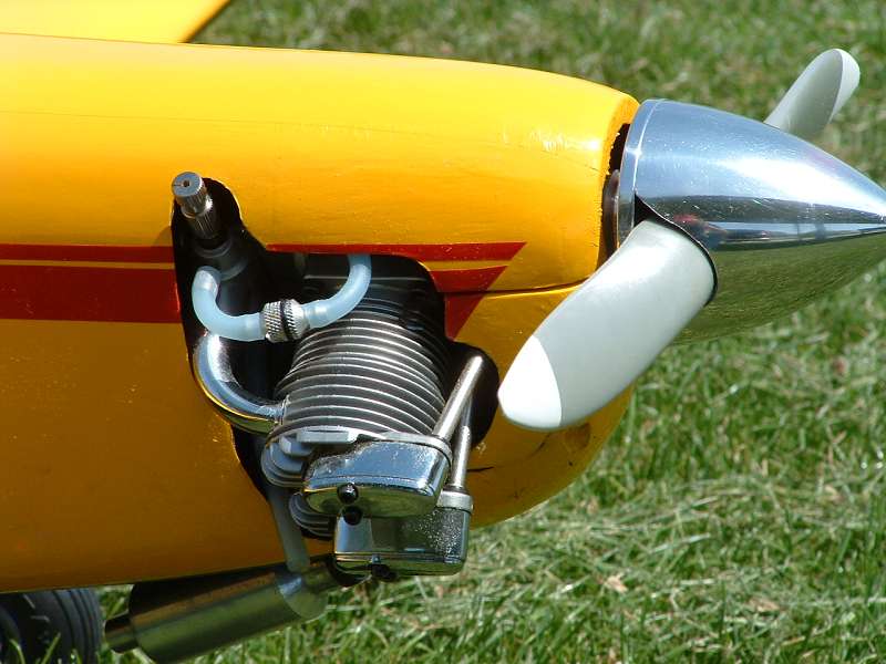

Old 04-25-2004 | 01:57 PM
My Feedback: (13)
Posts: 2,177
From: Center of the Flyover States,
Default RE: opinions please
Here is a picture of mine with a Saito.91 shoehorned in at about the 8:00 position. No pump, no problems, unlimited vertical with a 14x6 APC, 15% Red Max, 1870 elevation. This is a nice setup, but of course I had to do it the hard way. Weigh: 6 pounds.
