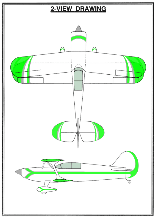

I have attached another post of mine that I feel is better suited for this thread.
"I think I will begin covering this weekend. The side profile design will be similar to my user icon (I found this pic somewhere, does anyone known what plane this is or where it came from? I'd like more info on it). I want this plane to have presence in the air and in the pits so the colors will be white, and florescent green with accents of silver. I have everything drawn up but I am still unsure about the bottom side of the wings. I was thinking of using white and florescent green in a checker board this may be too much, I don't want to induce epileptic seizures for spectators or other pilots. When I've been looking at the manufactured checkers they always seem too small or too big. Since I'll have to hand cut them I can customize the checker size to match the wing cord.
Suggestions needed:
What does everyone think for the bottom wing design? White and Florescent green or White and Sliver? Should I go with checkers or something else? Checkers seem to appear on Biplanes more often than stripes, and solid white seems too stark and Green too much."
Attached is a pic of the top and sides as I am currently leaning toward. Note the bottom design is not illustrated:

The last option that is easy, find a vinyl sign shop in your area that can cut sheets of the squares for you.
That way you get perfect alignment, size, and if your lucky a nice solid color with the ease of sticking them on. They have a wide veriety colors.
As far as colors for the checks, your lime green and white would be a nice contrast as opposed to silver and white. You want to make sure though that the top and bottom look entirely different because at altitude you want to know what is what.
