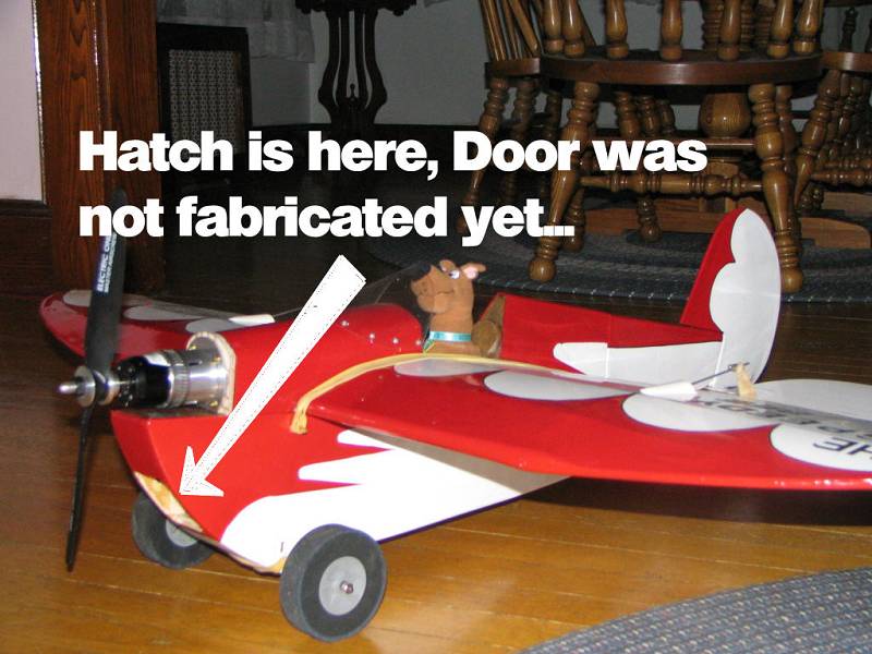

I have not "mounted" my battery yet. The air flow through the hole behind the motor is blocked by the wing. I may just "duct" it though the firewall, then down into the fuse and out through some holes in the battery hatch.
I will post details on my web site forum....

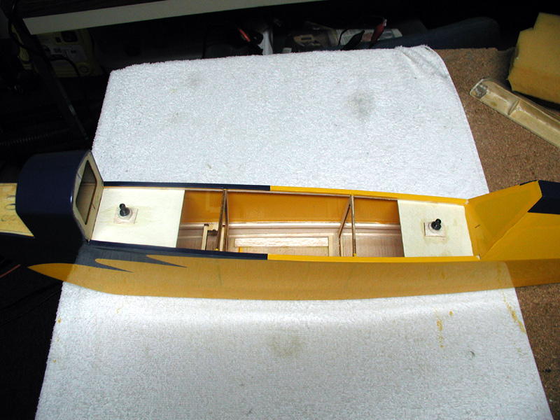

#46
On all of my electric Speedy Bees.....I made a battery hatch accessable form the front. The door is actuallthe the curved part of the bottom fuselage. It hinged from the botton and when closed....I would stck a wooden dowel thru with a small hitch pin on each side. I will see if I can find any old photos....
