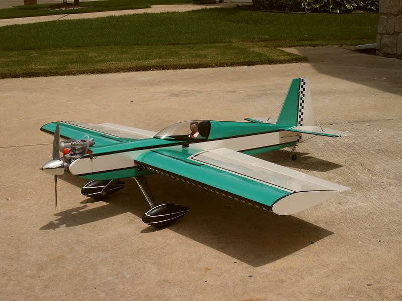

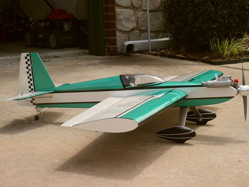

Finally, after approximately 14 months of starting, stopping, putting it up, bringing it back down, I have completed my first kit and also my first covering job. I have built ARF's in between, repaired other planes, lost a few in the process, and repaired others, only to always come back to working on my Something Extra. When I would get stuck I would come here to look for help, and you all were great in helping out. I must have 15 threads on the Extra in my subscribed to section and kept going back to them time after time. I am running a OS46fx with a JR R700 receiver and JR537 servos (yes, I know maybe I should have used others). I changed the main gear to raise the front and added a Sullivan tailwheel, but mostly it is a straight build. I hope to maiden this weekend, but not sure if I will get to.
I do want to thank all of you who responded to my questions and provided assistance when I needed it. And to those who saw me respond to other threads on the Something Extra with "...well I have a Something Extra that is just about finished..." Well it is true now. This website has to be one of the greatest.
BTW: This is my first covering job and I used Ultra Cote. I will do so again. (It is Pearl Green, Pearl White with Pearl Black Trim)
So now what do you think I am going to do? Put another on the bench?.....yeah right. No I am going to celebrate some, fly awhile, then probably in the Fall start on my Sig Hog Bipe! See ya in another 14 months with some more pics.....LOL

Did you replace the "slidy tube" elev/rudder control rods with wire or dowels or did you leave it per plans? If per plans, do they bind? If so, how did you "unbind" them--ie make them slide easier?

what landing landing gear did you replaced with, a .40 or .60 size?

-On the servos, there were those that thought that I should go with higer torque one's, but I think the 537's should be just fine for the SE.
-I did replace the "nylon tube" elvator/rudder controls. I kept the external sleeve and slid a 2x56 rod into it's place.
-On the landing gear, I am not sure, I just measured the stock one and bought one that gave me extra clearance. I think I added about 1 1/2" to the front by doing so. I bought it at my LHS and it wasn't labled or anything.
Regarding the 14 month's, remember that I did do other things. There were times that I just hung it up for a while. Since it was my first kit I did run into problems. I had to re-sheet the leading edge on one of the wings because I used too much Windex when bending the sheeting and it warped and couldn't be straightned. I had to do the front turtle deck over because the balsa that came with the kit was too stiff even after trying the Windex method. I have attached two pics of what it looked like. And as far as the covering, boy I took my time and went very slow. For those who might be wondering, I did cover the parts first like you get in an ARF, then went back and removed it where the epoxy went. I also re-enforced the tail where the Sullivan tailwheel is by adding another layer of light ply. Sorry no pics of that.
