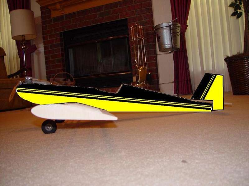

I also have a question about covering the fuse. I am going to cover the sides in yellow and the top in black (see picture). Do i need to make the turtle deck and the black that extends down on the the fuse two seperate pieces since the monokote over monokote? Should The black piece on the top deck also be a seperate piece? Thanks, Shaun. (I just took a pic of my plane and colorized it)
