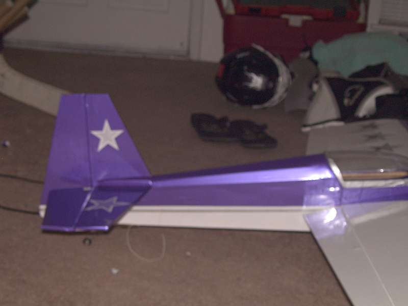

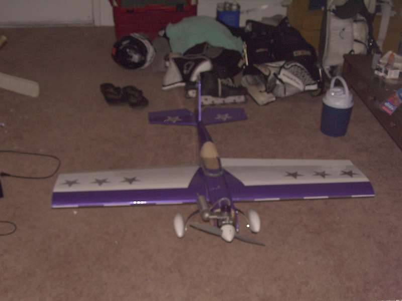

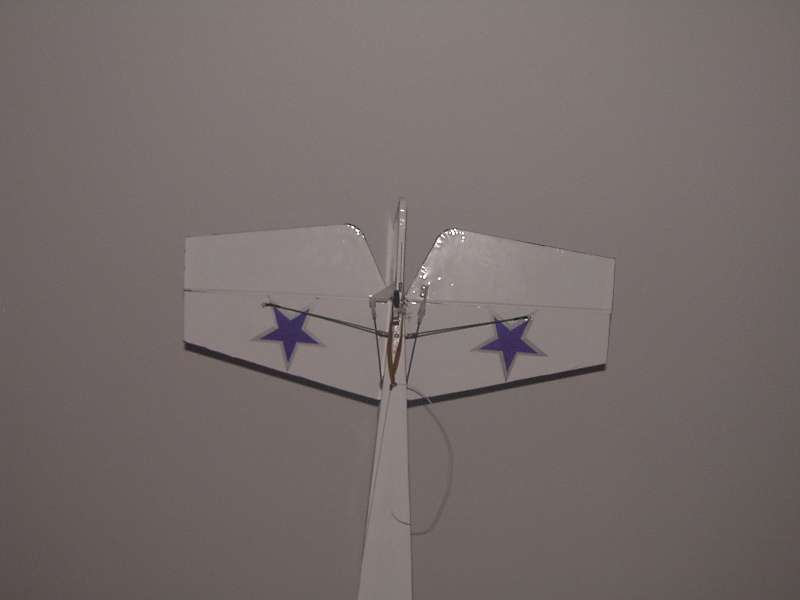

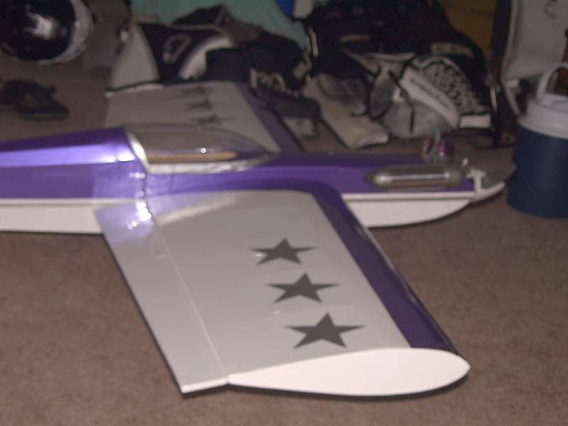

Built mine a few years ago and as I remember it was an easy build, if i were to build another i would not use the SIG control rods as they expand alot were you screw in the threaded rod and bind on the outer sleeve.
( the little gold stars were put on by my 6 year old lad, anything to keep them quiet. )
