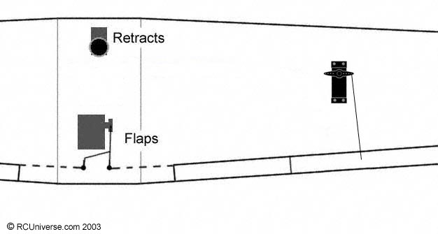

As said, you don't need them, but you could add them, then cut about 8" off of the inboard ailerons off and use the torque rods for flaps.

Old 07-21-2004 | 03:25 PM
Joined: Sep 2003
Posts: 324
From: NtheStiks, VA
Default RE: aileron torque rod question
Thanks for the help guys. I was afraid that by not adding the torque rods, the stability of the aileron might be affected...I'm gonna use CA hinges, but I'm guessing with the small gap between the TE and aileron, probably nothing to worry about.
