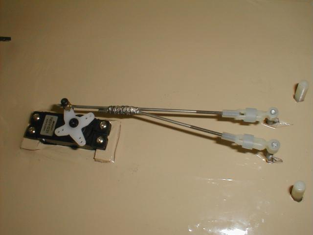

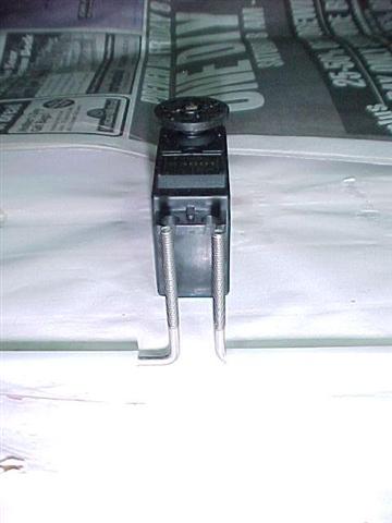

If you had two torque rods and a servo, what is the way to hook this up for FLAPS. Thanks

Solder together two rods into one clevis. Thats how Ive done it

Solder your linkage into a "Y" link. Put an adjustable clevis on the servo end and the right flap. solder a non adjustable clevis to the left flap.
This way you can match the right flap to the left one and adjust both with one clevis.
DEG

Just a picture to illustrate what they said...
