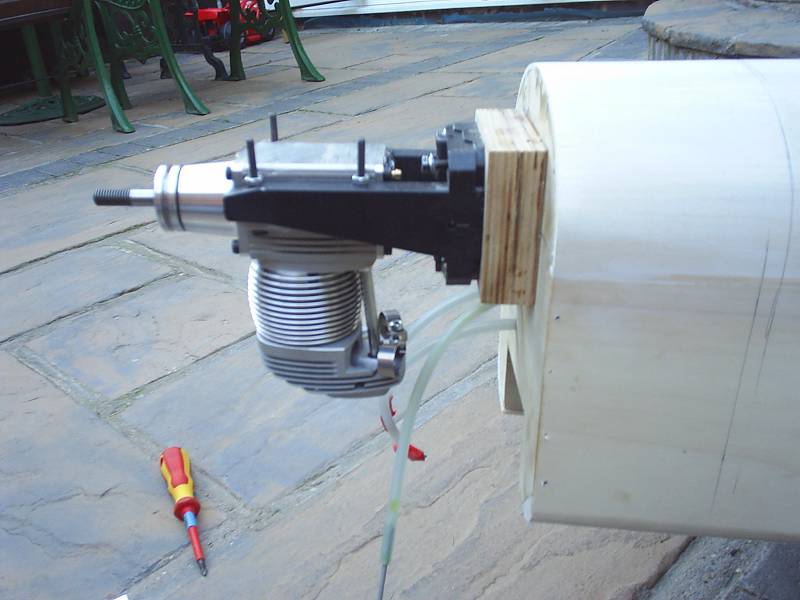

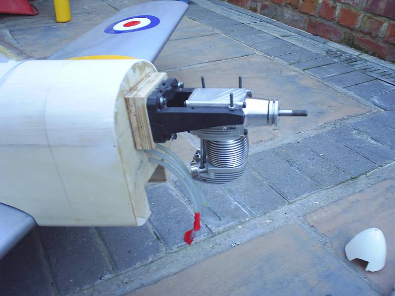

Yes, I run mine on muffler pressure but it's not necessary as most of the guys here do not use it. Just one more thing to go wrong I guess. Old habits die hard. Make sure cooling is adequate as 4 strokes run hot. Baffles to direct airflow over engine and cutting cowl open at bottom for air exit will be necessary.
I used MDF (instead of ply...much heavier) to bring the engine and mount out to meet the cowl line.

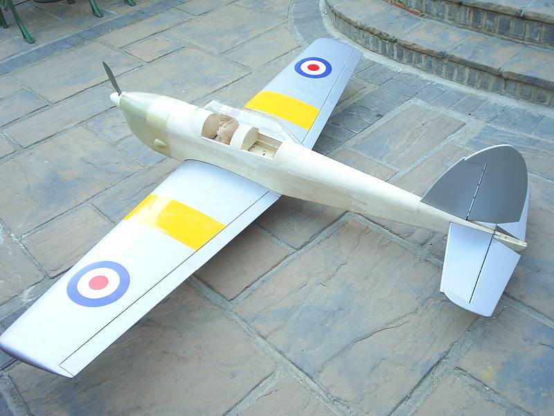

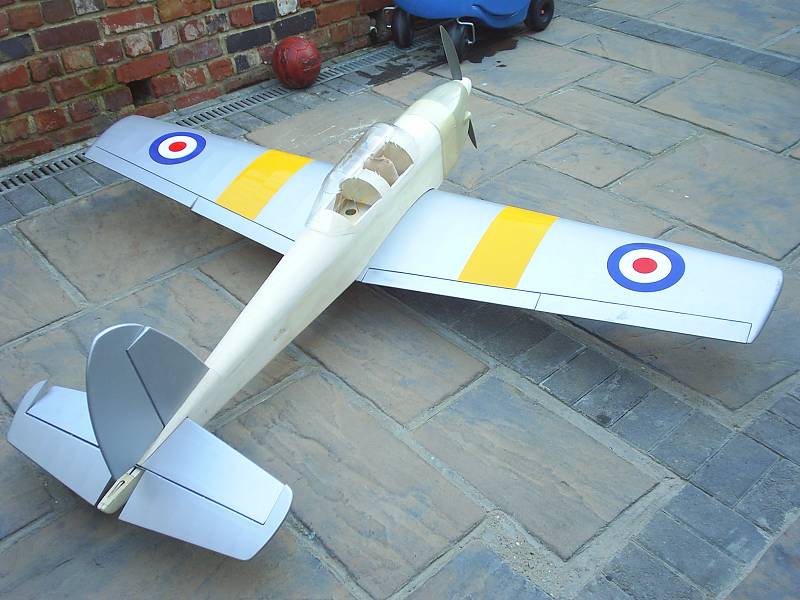

hello Ron, a few picts of airplane. Ive used a GP adjustable mount, had trouble obtaining any others, a golberg snap on spinner with which i found very cowl alignment very easy.Brand new laser 150,as of yet still unrun.Ive purchased 2 futaba 5kg servos as the manual suggests,not be long now before shes ready for the off.
#94
Joined: Dec 2003
Posts: 51
From: HorncastleLincolnshire, UNITED KINGDOM
Hi Frank,
Chipmunk looking good. The fuselage appears to be covered in nylon? My Laser is mounted identical to yours. What about cooling? Will you be placing deflectors in the cowl to direct incoming air over the engine as shown in the Laser instructions?
