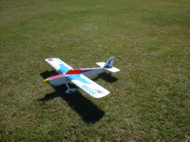

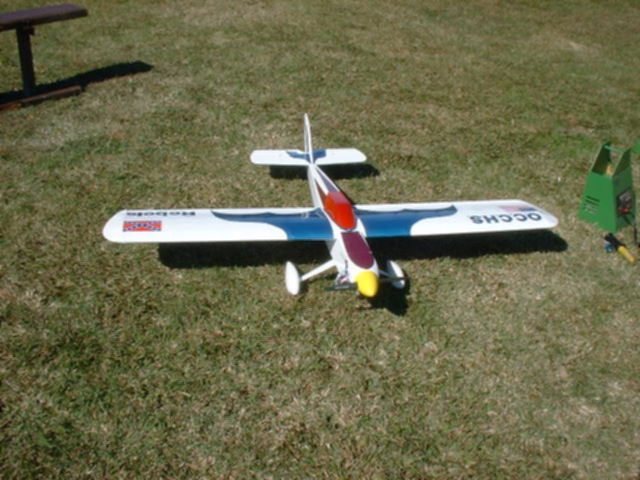

I love my Midstar
I would highly recommend sheeting the leading edge. I have experienced out of trim conditions from one flight to another in the hot summer days. I would also say build it as a Taildragger it behaves very well. I have been flying mine without tips
here's a pic
here's a pic
