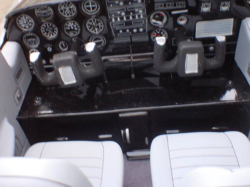

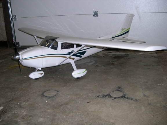

Nice kit - I'd be glad to answer any building questions as well.....
Here's some photos of mine....
Scott

Received mine today. The kit looks like a quality kit.
Also received the cockpit interior, robart nose gear strut and a full set of navigation lights.
I hope to start the build in a few weeks time. I intend to go as far as I can with scale items. I see there are several threads here where people have built some impressive planes out of this kit.
Nice work on your plane Scott, what engine and muffler combination did you use?

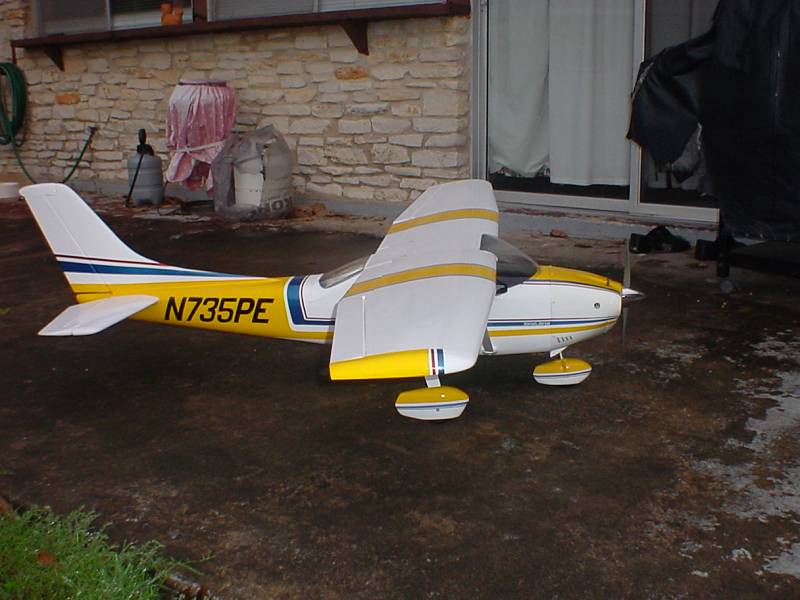

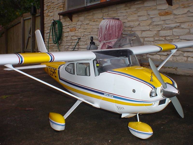

Here's my nightmare.

What do you mean nightmare?????? That is an absolutely georgous bird!!!!
