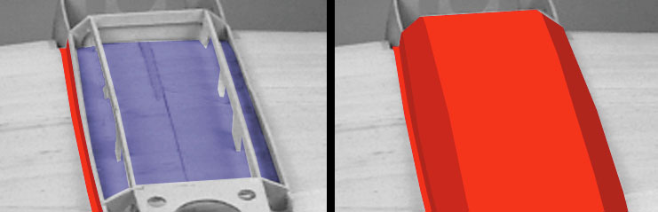

I am finishing up my GP extra 300. How do i cover the belly pan. I am using film and I cant for the life of me figure it out. Do I cover the edges of the pan then do the center of the wing inside the pan. Do I cover up to the edge of the pan then cover the interior of the pan with one sheet so you don't see the middle of the wing. I am confused please shed some light on this. I couldn't find any answers in the forum search.

Start with a strip about 3/8" wide along the seam where the pan meets the wing. Don't worry about the center of the wing at all (Blue area)
The cover from one of the 3/8 strips to the other. You can do that in one piece, or three if need be.

Thank you so much. It is so much easier than I had thought. I guess it just didnt click with me when I was looking at it.
