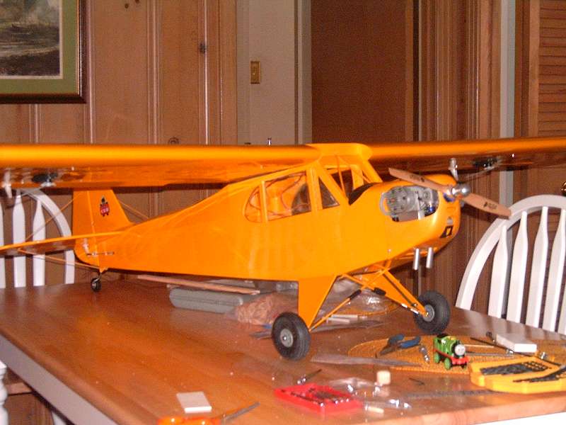

This will be a long reply. I received one of these (76") kits as a gift. What a curse! A $100.00 gift that I spend $400.00 to $500.00 to complete. I would send my ex-wife one out of spite but she would never feel compelled to attempt it.
It is a great airplane and a good kit. This was my first and I finished it this past week. It is beautiful!
I made some changes from the plans. I installed two aileron servos in the wing rather than the single with torque rods. This also gives me flaperons, which may be extraneous on a Cub, don't know yet. If you do this remember to add the servo wire holes in the ribs from the servos to the wing center. I used z-bends on all servos and Sullivan golden clevises with hangar 9 control horns. Used a Sullivan Precision Rod for the throttle (to an Evo .40). The controls are 100%slop-free and positive. Used robart hinge points-they are great and I feel a lot more comfortable with them than ca hinges. After installation the control surfaces would just drop from their own weight when lifted then let go-extremely slick. I added an additional (3rd) hinge point near the bottom of the rudder and reinforced the eyelet which holds the tailwheel steering wire with CA'd nylon fabric. I added backing blocks for the hinge points inside the contol surface framing at the hinge locations. I drilled and tapped the wing mounting blocks for 1/4-20 nylon bolts with nylon washers to do away with the T-nuts and small hex screws for the wing attachment and used black self adhesive wing saddle tape instead of silicone caulk. I replicated the landing gear shock struts on the box photos instead of using tiny dowel rods as the instructions suggest. The instructions indicated this could be done using 3/32 brass tube inside of 5/32 brass tube. Save an unnecessary trip to the LHS- it won't work. I used 1/8" inside 5/32- that works. This is the only place I used the cheesy snap links included in the kit. I also made the struts an airfoil shape instead of just rectangular and covered them instead of painting them. I primed and painted the interior of the cabin and fuel tank/receiver/battery area. The sealing iron will melt the paint though, so plan accordingly where to paint and where to end the covering material. On the advice of the extremely plane-experienced LHS owner, I used Cub Yellow Econokote. I think he suggested it (instead of Ultracote or the Solartex I planned to use) because it is great for first-timer covering jobs. It IS great stuff and I was extremely impressed with it's qualities-especially the low adhesive melt point and how easy it was to work around curves. I took it by for him to critique and he was very impressed and surprised at the end result (I am very meticulous and wouldn't have dreamed of just slapping this project together). That said, I wish I had used the Solartex as it would have looked better than the shiny, plasticky-looking Econokote, which is more translucent than opaque. This plane is a lot of work and I would prefer to put a few more dollars into high quality components than risk it to cheaper quality parts. Heck, I'm almost afraid to try and fly it. I doubt I will build any more kits, as the care and attention I put in make me reluctant to risk crunching it; an ARF would have a lot less of me invested in it.
If you are an experienced kit builder you are probably used to some of the things that caught me by surprise. The directions are good, but not flawless. Read ahead, plan and re-read over and over at every step. I built this plane over the plans, EXACTLY to the plan. I built the wing last instead of first and when it was finished the opening in the front of the wing was 3/16" too narrow to fit over the fuselage. Talk about head scratching (and expletives and throwing things, and cursing Carl Goldberg, whoever he is/was)! I measured both assemblies and measured the plans. Then did it a few more times for laughs. The plans were off. If built exactly according to plans there was no way the wing would fit over the fuselage in the front! The wing tip framing (step 22) should be tilted upward somewhat, but the directions are a bit unclear on this and it isn't super apparent when gluing it up to the ends of the spars. Mine wound up not tipped up as far as they should be, but the underside of the wingtip turns up a little (just less than it should) and I doubt it will affect the flight performance dramatically. The tendency when building the wing on the building board is to put everything flat down on the board, my mistake, which caused this. You may have much more experience than I and may know more of what to look for when building. The instructions suggest washers for right thrust, but I used a wedge of ply strengthened with a soaking in thin CA (I installed the washers but they sank into the epoxied firewall). In step 5, not paying attention, I glued doubler CT to former C and promptly covered up the prepunched dot showing the drilling location you'll need later.
All that being said, I was pleased with the kit and would buy another if I wanted to build another kit. Can't really knock Goldberg as the plan fiasco on the wing/fuselage fit could be due to plan shrinkage or the loose nut between the plans and airframe. It balances exactly on the main spar which puts the balance point square in the middle-rear third of the CG range with an empty tank. I had to add about 3/8 oz. of lead to the left wing on the third rib to totally balance it laterally. That is all the adjusting necessary to balance out the completed airframe,
If I can help give a shout. I am sure given time I could think of a couple more hints, but that is all that comes to mind right now. I second the advice to build it full-sized then order an additional wing kit and build an extra wing clipped- that way you can have the best of both worlds! I tried adding some pictures but that will have to wait for another time.
Hope you enjoy the build and beautiful completed Cub. Use that Solartex!

Thanks for the input on this kit. It sounds like you really enjoyed the build. I havn't started on this project as of yet. I bought it at a swap meet last weekend and upon opening the box, I found the instruction booklet missing. I called Goldberg on Mon. and rec'd a replacement on Wed., great sevice. However the replacement was a copy instead of a printing and the quality of the photos is very poor. I havn't looked at the hareware pac yet, actually I have't even taken the rubber bands of off the wood yet. I think my kit is an older kit as the booklet makes ref. to not haveing to use a 1/4 ply spacer as the instructions indicate as the kit now has a nylon engine mount. Well my has a alum. mount. I don't see how this will be a problem.
I friend which is a master builder suggested to cver with 21st Century fabric. He calims once you use the fabric you won't want to use film again. We will see.
This is only my second kit, the first being a Goldberg Tiger 60. I bought this kit for a winter project but I don't know when I will get to it as I just bought anothe house and in the middle of don't some redecorating before we move and of course have to go to Fla. right after Xmas.
I know how you feel about flying your own creation after having so much of you into it, I felt the same way about my Tiger. However the first time I dumped it didin't hurt as much as I thought it would. lol. The Tiger is my second plane as I just soloed this past summer. the Tiger still lives though.

No, haven't flown it. I am still tinkering with some tiny details. Have taxi tested!
I am looking at some actual J3's to determine how I will trim it. This started out going to be white with red trim but i allowed a four year old to overrule me on that. The last plane my dad and I flew together was a red/white restored Super Cub. I wanted to build it like that but keeping the boss (the four year old) happy was more important.
I didn't check lateral balance and CG until after I covered the airframe-consequently I had to cut and patch the covering on the underside of the wing in adding the lead weight to balance it laterally. I would balance it before covering next time, at least cover everything but the wing, then balance, then cover. Incidentally, the Goldberg instructions never mention lateral balance, but I kept noticing that the wing was slightly right side heavy during the build so did a little research and found lateral balancing info.
You may have a slightly older kit if it included the alum. engine mount, but I believe they still specify adding the washers between the firewall and engine mount for added right thrust. I did it that way but discovered they were sinking into the plywood firewall even though I had thoroughly epoxy-coated the firewall. If you haven't discovered it already, there is a great website, Aircraft Proving Ground(s), that is an invaluable source of information for building. I learned the plywood wedge thing there and it has worked so far. The washers would have eventually buried themselves in the wood, negating the intended right thrust for the engine. The pressure of the engine mount bolts is just spread over too small an area with the washers-the wedge spreads the pressure over a much larger area after the bolts are torqued down, eliminating the mount/washers sinking into the wood.
I did a LOT of research to decide on Solartex, but Coverite is supposed to be great stuff also, just heavier. Don't want to start a debate thread on that subject. I just felt being lighter can't hurt on a seven to seven-and-one-half pound .40 airframe. That is some of what led me to follow the LHS owners econokote suggestion, it IS light, lighter than I believe Ultracoat, Monokote, Solartex or Coverite 21st Century.
Also, nicadflyer was a big help when I was just getting started. He helped me figure out a muffler and some other stuff. Much thanks to him and the others that assisted me with info and photos.

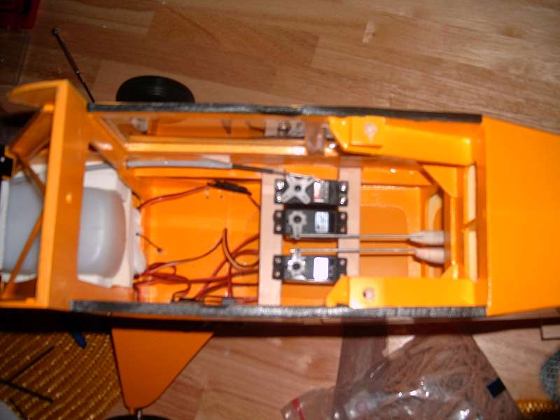

I haven't cleaned up the inside yet. I am still going to add some screws to the ply servo rails as I tested them and they could be popped loose with enough pressure. The epoxy wouldn't adhere to the paint as well as it does to bare wood. Sorry, but I could not get but one picture per reply to work so I just made four individual replies. Hope you have fun with it and it turns out great!
Bill Duffel
