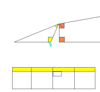

I need some suggestions. I have a Kadet Senior that has been set aside for the moment. I have built the tail feathers, fuselage, and 1/2 of the wing. The wing is being modified to add barn door ailerons. My main problem is how to do the control horns for the ailerons. 4 of the wing ribs were cut just after the back spars. Here is a very rough drawing of what it looks like. I imagine that the section in blue is what the control horn would sort of look like. What is the best way to do this, or should I back off and do it another way?

For just a trainer I would make new ailerons and center line hinge them the normal way. Just make servo pockets for easy installation. I would think maintenence would be more important at this stage. Just my opinion. I've done the top hinge before and it works fine, I just do it on more scale planes. Attached is how I do the control horn. Stays hidden.

What you have shown should work fine. You can make your own horns out of 1/8 inch aircraft grade plywood (use ball links for best results) and get by nicely. Do take out most if not all the dihedral though or your ailerons will be very ineffective. I've made several with absolutely no dihedral (as long as ailerons are added) and they flew much better than the stock units. Even then you may need to couple in some rudder on turns to make them look right. Use two servos, one in each wing.

I have 2 different ideas on how to attach the control horns. First is to predrill the holes for the screws, mount the back plate inside the aileron (remember this is stick built) and glue it in. The second idea is if I use plywood for the control horns, I would epoxy it into a slot in the aileron just like you do the dihedral brace.

One other thing you might want to do with the control horns is move them back from the front edge of the ailerons. By moving them 1/4th of the way back, you will get a differential throw, more up than down. Just a thought.

Well, as usual for me I keep collecting opinions. I stopped by the LHS and talked to the manager (who is also Pres-elect of my club) and got his take on how to do them. I converted his chicken scratch to the drawing you see below. The only thing I got wrong on the drawing is the control horn. This should show it mounted to lite ply right behind the spar on the aileron, instead of right on top of it.
