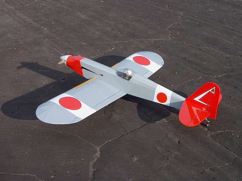

This depends on your skill. The engine is not too much. I have had 2 4-Star 60s, both bashed into Kawasaki Tonys, powered with an OS .91FX and a Magnum .91XLS. Both had Ultra Thrust mufflers for more rpm on 14-6 APC props. Both had excellent vertical-as far as you want. Landing was still slow and easy. I did more the main gear to the wings for a more scale look.
You can also run the OS on a 13-6 or a 12-8 and let it rev. The .91 makes it a whole different airplane.
