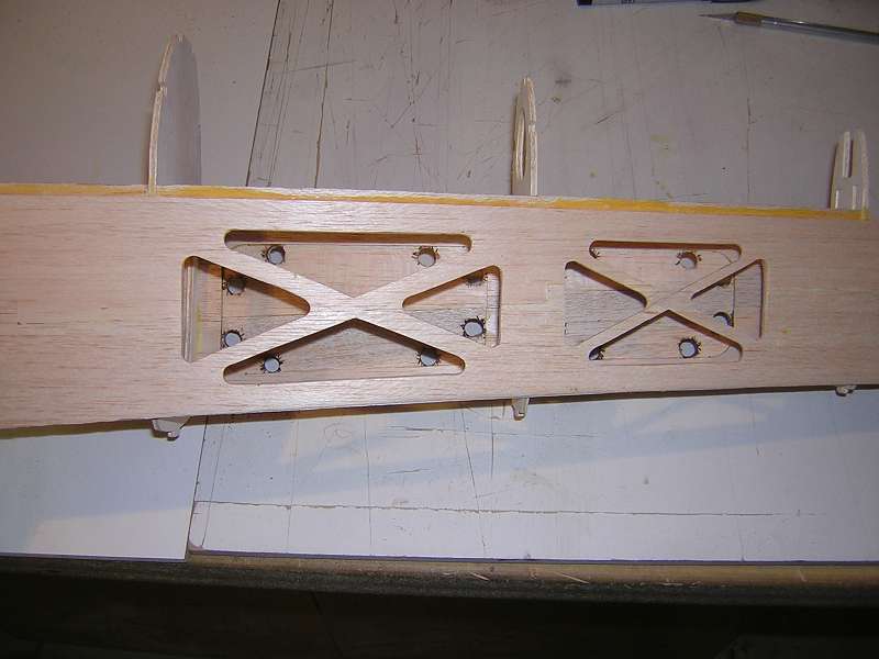

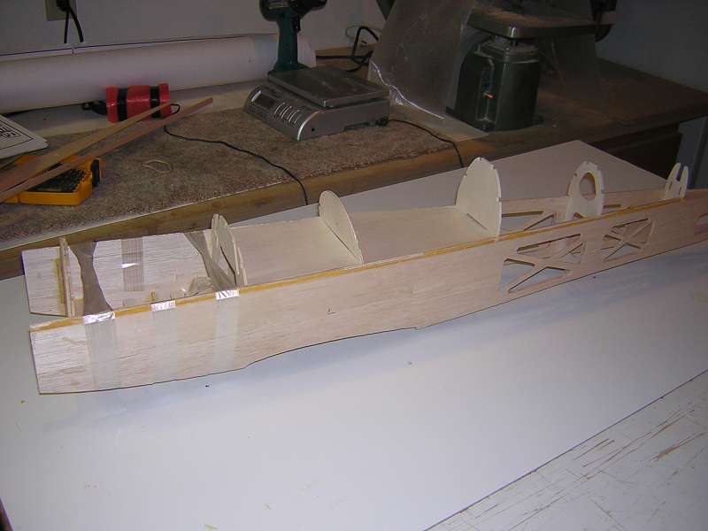

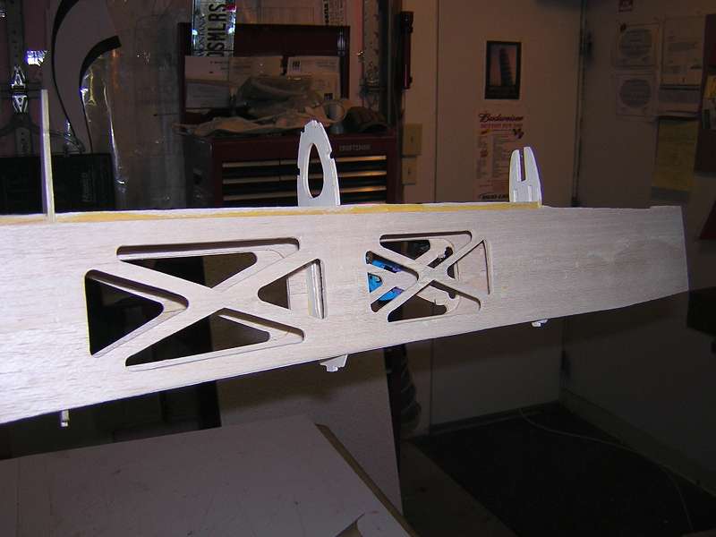

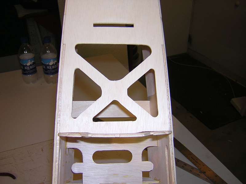

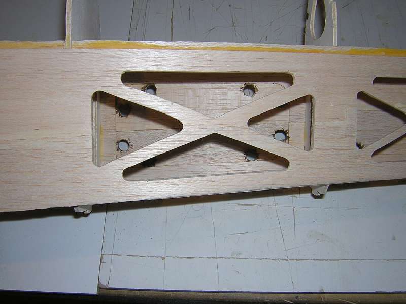

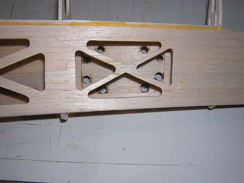

Hey guys, I started my lightening project and wanted to see what ya thought about what I have done so far. This is only my 3rd kit, but I have a few ARFS and a few of my own coroplast designs under my belt. I thought it could be used as a future tutorial, as I am willing to experiment with this build. I am open for suggestions, but please don't feel offended if I don't heed somebody's - in favor for- somebody else's advice. THE FOLLOWING PROCEDURE IS PERFORMED ASSUMING YOU HAVE ALREADY GLUED THE REAR HALF OF THE FUSE TOGETHER.
I got busy with the #11 exacto, a steel straight edge, a pencil, and a couple of sanding (180 -150 grit) tools I custom made from a small dowel, and a small thin (1/8) HARD piece of basswood. I started by poking T pins in from the opposite side, right at the point where the curves start in the inside of the fuse on the doublers. This was done to make marks on the OUTSIDE of the fuse. I was generous with my marks, making my 'lattice' plenty wide, like a 1/2 inch or so. I never went any further than the doublers on the inside. Therefore, the work is done inside the doubler's hole, and any cuts must be done in a fashion where you KEEP THE STRINGERS WIDE ENOUGH inside the hole you cut.
Pic #1: I Dremeled out the round corners, keeping in mind that the stringers have to be kept wide for future sanding.
The rest are just pics of different stages of sanding. You get the idea.
I use a precise digital scale, and the fuse weighed 8.9 oz at the before stage, and 8.1 at the end (nothing ahead of the REAR wing bolt is in place yet). I lost exactly 1/2 ounce with this mod so far, and I haven't decided what to do under the tail portion yet.

Old 01-04-2005 | 12:02 AM
Posts: 4,734
From: Spring Hill, FL
Default RE: Lightening the GP Skybolt
You did nice work on the fuselage but that's too tedious for me. One thing you could have done is built a trusswork fuselage over the side view. Every GP kit I've seen had a lot of heavy wood in it. It's not just them. That's mostly why I scratch build because if I bought kits I would take the time to cut out new parts which makes it not a kit any more.

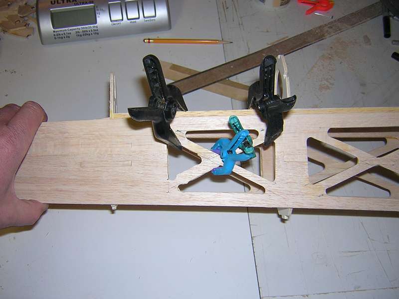

Some more, notice the clamps where I broke the dang stringers!!!! [:@] I reglued with Titebond, as that is all I am using on this build so far. It is soooo much easier to sand than CA!
I thought maybe 1/16th ply in the 'X' part would help strengthen things, but then I thought I would just screw myself on the weight. It seems strong when it stays glued together.

ORIGINAL: CafeenMan
MMmmmm, tedious. I actually loved every minute I was doing it. I have a thing for retro fitting. Reverse engineering is also a favorite of mine. I can understand things better that way for some reason.

Old 01-04-2005 | 12:12 PM
krossk's Avatar
My Feedback: (27)
Joined: Mar 2004
Posts: 1,251
From: Port Washington, WI
I'm reading this thread with great interest as I have just bought this kit for future construction.
Are there any concerns about the "truss" portion left after the lightening holes are cut spanning longer cross-grain distances?
I'm thinking about the case where the well-intended helper picks up the plane and applies pressure perpendicular to the "truss".
Wouldn't longer holes leaving trusses parallel to the grain produce a stronger structure? Something like this:

I am no expert by any means, but my 'X' truss is very strong, and retained the curvature of the fuselage.

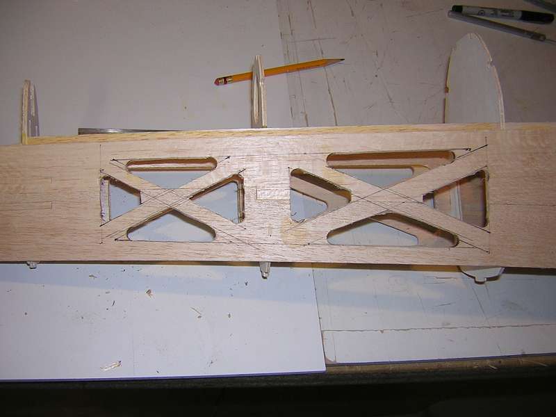

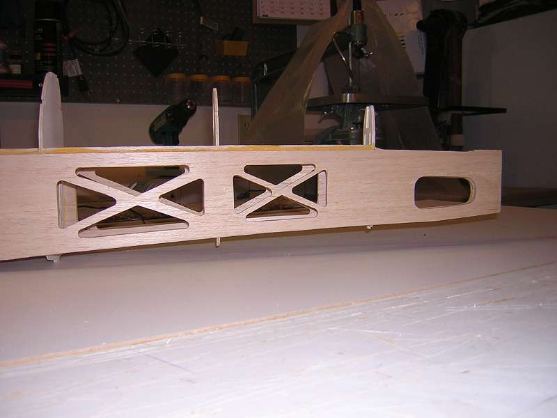

Well, I lightened the tail, with a total of a tad over 1/2 ounce, and am now open for suggestions. I thought about lightening the cockpit floor, between the dashboard and the former. It has a structure above it anyway. Maybe an oval shape? What about the fuse sides? Should I even mess with them or will that compromise the strength?

I wouldn't hesitate to do both of those cuts.
As you can see in the Ultrasport pics, I removed everything inside the doubler holes.
One word of caution, I wouldn't get too close to the nose... That nose has to bend around to form a curve, lightening holes too close to it can cause problems. So I would avoid any cutting forward of the lower wing saddle.

I've cut the cockpit floor, lost 1/3 ounce. I have drawn on the fuse for what I think I will do for my next cut. Do you think I'm still in the safe zone?

The only reason I ask, is that a fellow club member (with 20+ years experience) stopped by and said tot he effect that if I cut out more of the fuse, the tail may sanp off in a hard snap roll or the like. That scared the exacto right out of my hand.
Old 01-08-2005 | 02:56 PM
MinnFlyer's Avatar
Posts: 28,519
Received 9 Likes on 9 Posts
From: Willmar, MN
No problem, here's what I would do:

OK, Minn, I'm going for it. Once again, a picture is worth a thousand words. I will have to adjust the cuts a little bit to clear the wing bolt plates, and I will stay behind the front plate entirely. I'll weigh before and after.
I've begun on the bottom wing. I read where you mentioned eliminating some ribs. My LE and TE pieces are 'dato'ed to fit each rib. Was your kit like that, or did they start doing this after you bought yours, I wonder? Anyway, I would have to re-dato or just skip ribs if I were going that route, right? There does seem to be an overabudance of ribs for such a thin wing. I appreciate the time you have taken with me, Minn. Thanks a bunch!

I see, I must have misunderstood. I just weighed all the ribs for 1/2 of the lower wing, and they totaled 1.5 ounces. I'm not sure if it's worth it or not. That's only 6 oz of ribs total. That includes the plywood ones.

ORIGINAL: Deadeye
It doesn't count if the grain direction is wrong, which in this case it is. Still probably strong enough. I'd trust it.

Posts: 4,734
The grain of the diagonals should go from corner to corner. If all he did was make cut-outs in the sides, then the grain goes front to back. That makes for weak diagonals. If he were to glue some sticks behind the diagonals it would strengthen it tremendously but also put much of the weight back.
In any case, the plane is probably going to be strong enough as it is and I would just leave it alone. I was just making a point about trusses and what makes them strong.
