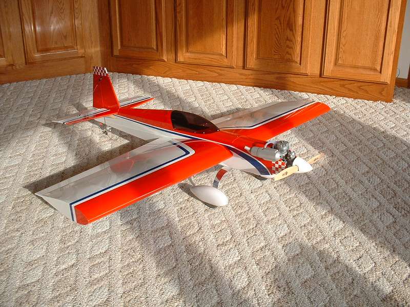

Posts: 163
From: Lenexa, KS
Default RE: OS .50SX for SSE?
Good choice. You'll be happy with combo.... here is mine.
