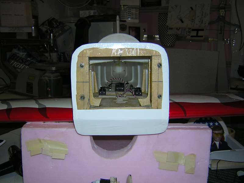

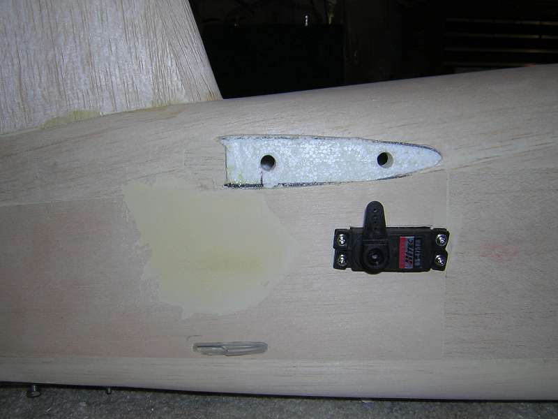

Hi everybody. I thought I would share some pics of the mods I've done on this plane. I've had it since May 2004. I picked it up at a swap meet from one of my best buddies (he had it from an estate). I got the already built fuse, and the rest of the kit for $30 (like I said, a good friend). I wanted to make it 3-Dish, even though I've read about the snapping habits of the plane. I am going to power it with a 45cc Homey, that will put out 22-25 pounds of thrust. My AUW should stay in the 15 pound realm. I should at least be able to hover the thing, I would think. It is sheeted with 1/16th balsa. I added about 2 pounds doing this with poly glue.

In the first pic , you will notice the big honkin' Hitec (177 oz) 1/4 scale servo for my rudder. It is probably not neccesary, but it needed a home.
Old 01-12-2005 | 12:01 AM
Deadeye's Avatar
Posts: 4,516
From: Dutton, MT
Default RE: My Byron CAP-21 mods

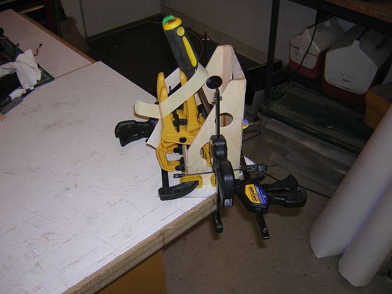

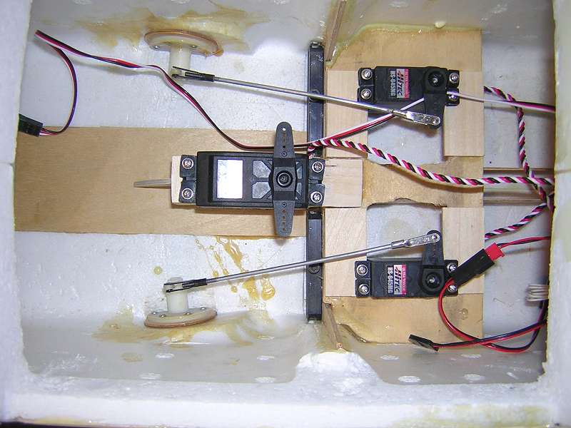

Second pic shows my elevator mod. I eliminated the long fiberglass rod, and corresponding linkage. It weighed in at 1.7 oz. My Hitec 475's wiegh 1.5 oz each. I figure that will be a good offset for the Sullivan smoke system that is going in the front.

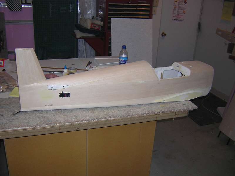

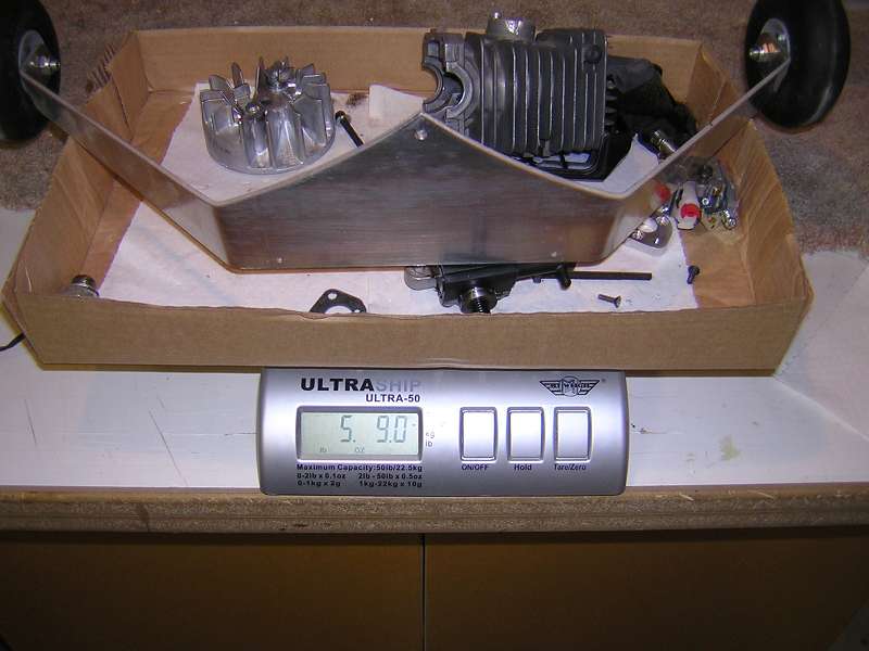

JeffH, I have never weighed it all, until today after reading your reply. The first weight of 7 lbs 9.5 oz is the airframe with all the radio gear, minus a throttle servo. It is also missing a pilot, and is not covered (Monokote) yet. My second weight of 5 lbs 9 oz is the landing gear; and all the engine stuff, minus a prop, a muffler, prop adapter, velocity stack and mount. My third weight of 11.3 oz is the fuel tanks, and smoke pump.
That puts me under 14 pounds lbs right now. I guess that foam is heavy, but I think I will keep it under 20 pounds. Thanks for the heads up.

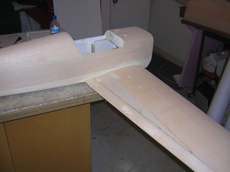

The sheeting is held on with polyurethane (Elmer's ProBond). The fuse was done one sheet at a time, using lots of masking tape and wieghts. Same for the tail feathers. I had a little help with the wing. I happen to know a wing cutting expert, and we made a whole new set of wings and saddles using the existing wing as a template. We used those saddles and a lot of weight to sheet the wings. I also now have another set of wings for another project. Total cost of the new wings is about $4. Total time to cut them was about 2 hours. Sheeting was about an hour.
I got the rudder and right wing covered tonight. It's lookin sweet, and I can't wait to start my trim job on her. I managed to do an excellent hinge sealing job on the right wing, if you don't mind me bragging. IF anyone has more questions, feel free to ask. I'll post some pics in the near future.

Eagle Flyer, I used the original wings, I used the saddles I made to hold the sheeting while it cured. I just weighed a covered half, and it came in at 1 pound 10.9 oz. So I guess a little over 3 pounds for both wings.

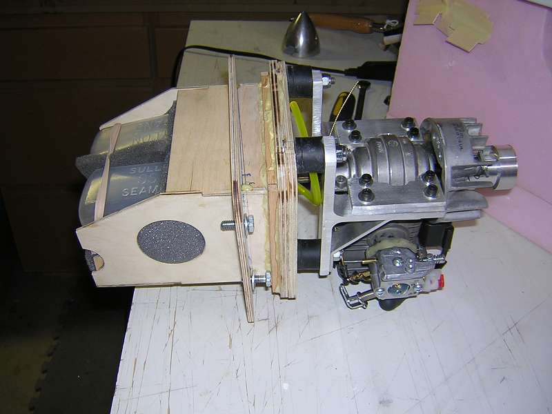

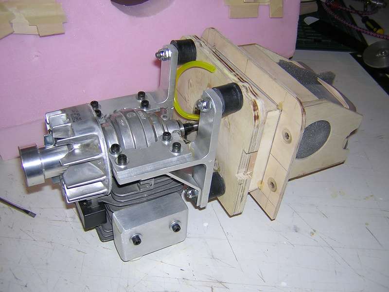

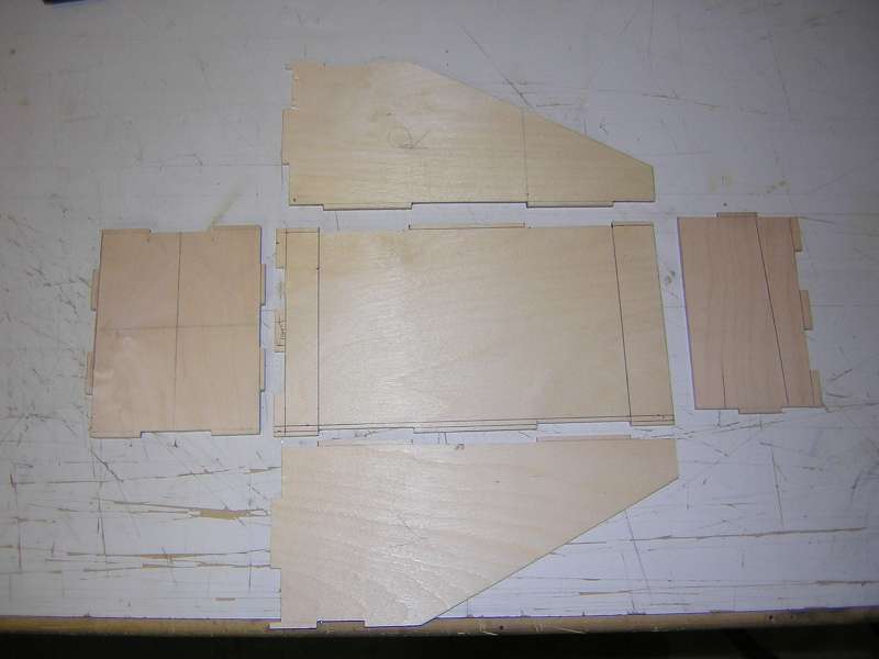

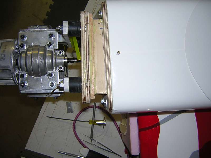

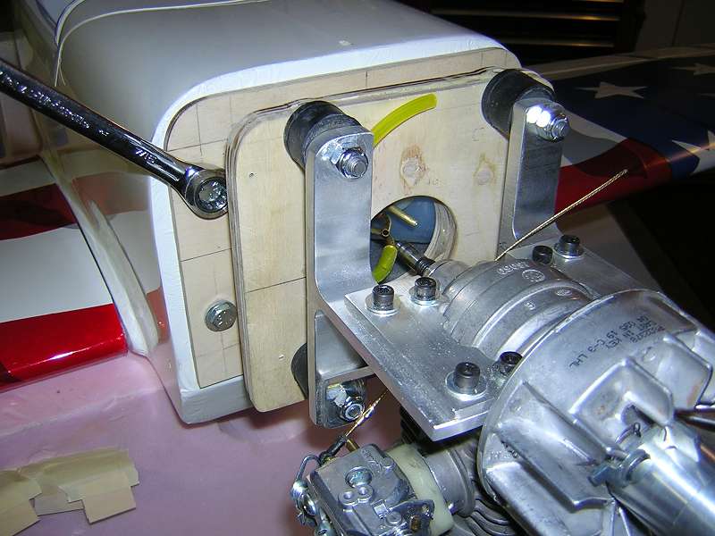

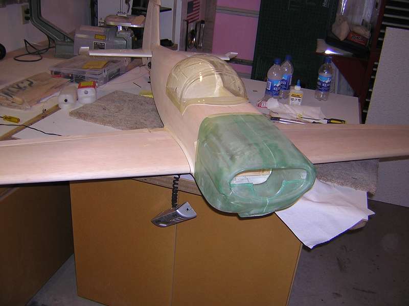

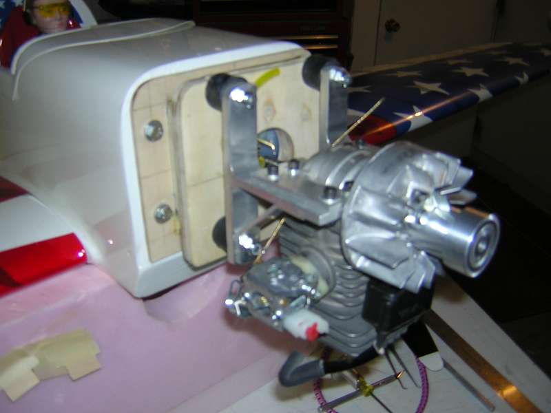

It has been a while since I have updated. Too busy building, ya know? I decided to do a box type of engine mount for this plane. It helped tremendously when figuring in my 2 1/2 degree of right thrust, and the engine side offset. I've got it tack glued right now, just making sure everything is true and square. Box is made of 1/8 ply, and uses 1/4" spruce stock for gusseting. I can remove four bolts, and slide the whole works out including fuel and smoke tanks (both 14 oz Sullivan flex tanks) for maintenence. I got the idea from looking at a fellow club member's Gee Bee racer. Upon further investigation, it looks like thats how the majority of the bigger birds are done. So much for being a 'visionary' .

My rubber mounts are Freightliner truck grille mounts. I payed like $14 bucks for all four. Most trucking places should have them in stock. My throttle servo (Hitec 225 MG) and smoke pump (Sullivan Skywriter) mount on the plate behind the rubber mounts. Loctite will be used all around, except for the aluminum mount to the firewall. Those are nylon locking nuts.
