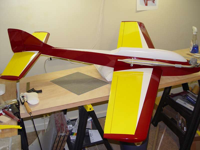

Anyone building (or built) a Bridi XLT? I'm about half way through building mine and wondering if anyone has any suggestions or tips on fitting the horizontal stab in this bad boy...???
Any other tips/comments on building the XLT welcome too.

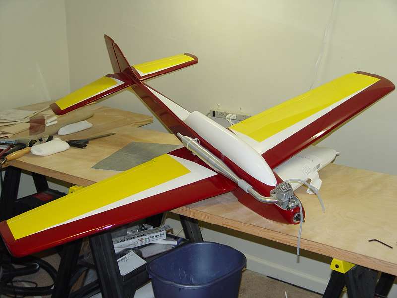

Default RE: Bridi XLT
I'm almost completely done with mine. Just need to complete the radio and Robart retract installations. I stuck with the 3/32" balsa sheeting for my wings, but used contest grade balsa and a sheeting process that keeps the weight down. I planned to use Monokote for covering the airplane so I wasn't too worried about the weight. It still came out pretty light. As far as the horizontal stab install I followed the instructions and just made a template using the plans and measured and cut the opening very carefully. It still was some work to get it glued in place but I shimmed it to the the exact incidence that I needed and then CA'd to lock it in place. Once that was completed I mixed a dry batch of epoxy and microballons and worked it into the gaps and smoothed it all out to permanently lock the stab in place and it made for a very solid installation. The engine is an OS FX61 with a MAC tuned pipe. Here's a couple pictures of my bird...

tschuy... I'm jealous... wish my XLT was that close to done... Looks good!
When you cut the openings did you cut the fuse to let you put the stab in from the top or the back? or did you just slide the stab in from the side??
I'm gonna try one of the new super tigres in mine..... ????? I've heard good and bad but I figure for the price I'll give 'em a try. Going with the .90 ringed.
I cut a hole through the side and slid it through the opening that I cut. Worked pretty slick but spent some time playing around with shims to get it lined up perfectly. Incidence is set per the plans at 0 degree's. Nice thing about the Bridi kits is that he gives you the perfect longitudinal reference by having the fuselage top flat. I just measure from the plans and found the center point for the horizontal stab leading and trailing edges to be 1". So I cut a template to the profile of the stab root and transfered those same measurements and traced the outline on to the fuselage sides and then started cutting carefully.
Thanks for the comments on my XLT. I mainly built it to get some pattern time and get proficient with the maneuvers. I'm getting started with turbines and was looking for an airplane that I could fly the speed of heat with yet be very precise. The XLT filled the bill for me. Will let you know how she flies when the weather improves a bit and I finish getting the radio gear in. I used Robart pneumatic retracts and stuck my airtank just behind the trailing edge if the wing and glued it to the fuselage bottom skin. The FX-61 is heavier and longer then the older engines that were being used in these airframes so there is a known issue with it being a little nose heavy so I wasn't too worried. I also went with installing ailerons out in the wing panels (use one servo for each aileron) and mounted those just behind the retract mount plates. I actually used the plate to hold the front servo screws and then cut and inlaid 3" long piece of 1/4"square basswood stock for the rear servo screws.

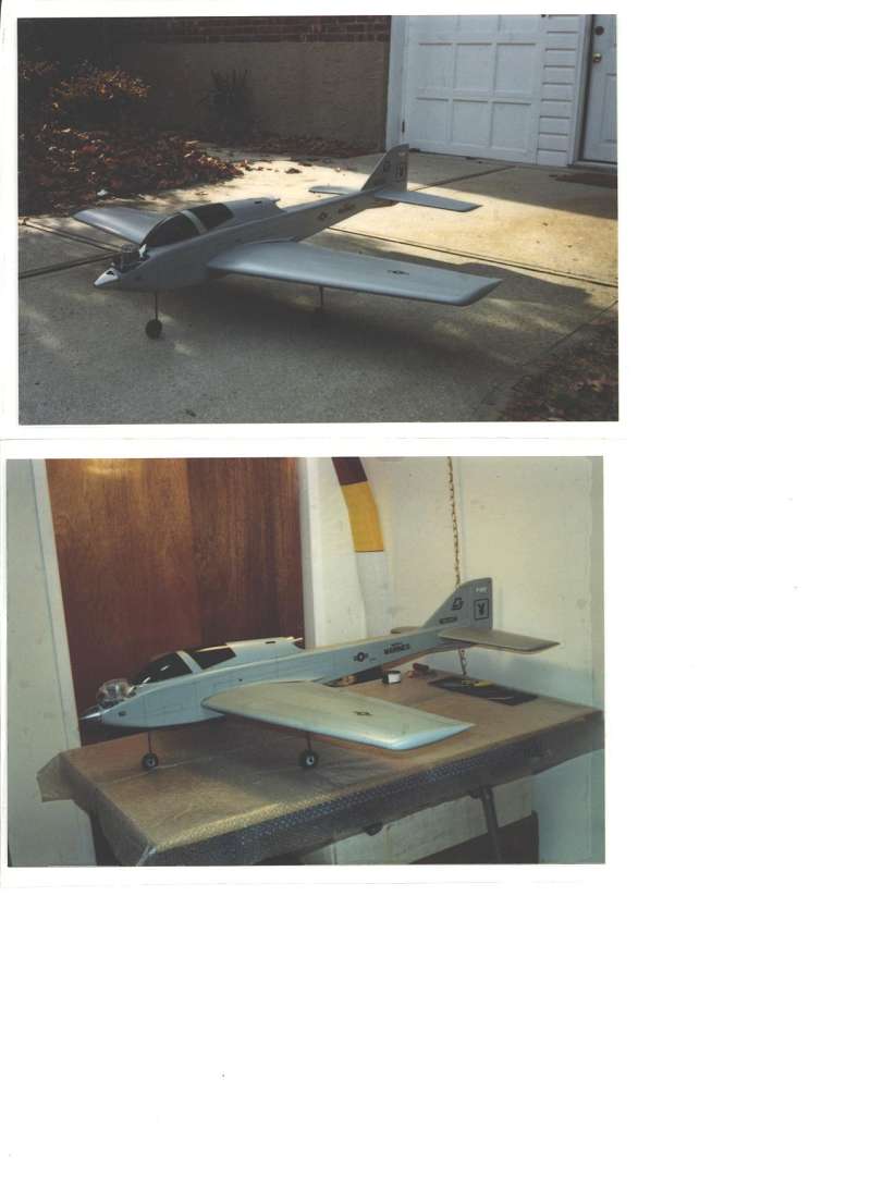

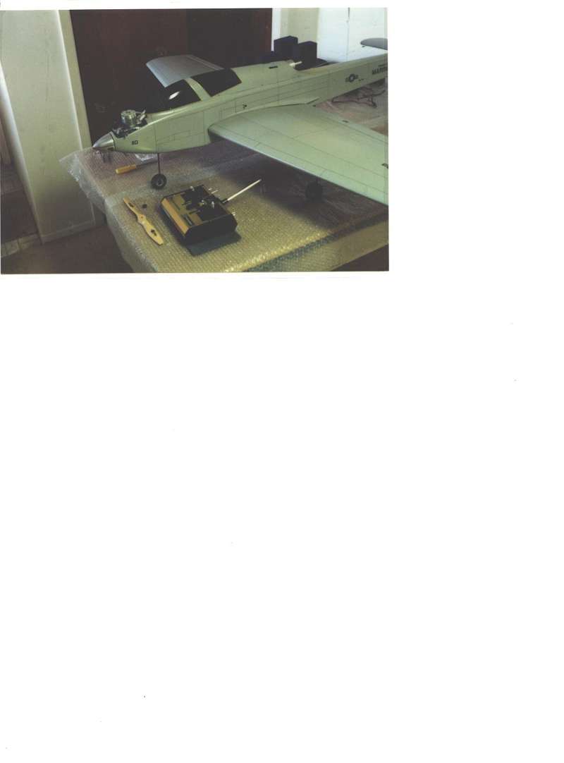

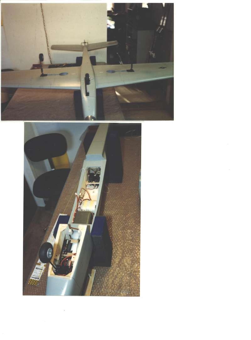

I built this XLT back in the mid 90's. OS 61VF, B&D retracts. Lost before its time. My wife bought me a replacement last Christmas. I love flying this plane.
Nice XLT you have there CAM2... can you tell us a little about how it flies??? stall characteristics, landing habits, etc...
Also... do any of you guys have close-up pics of your servo set-ups in the fuse... I'm planning on pull pull on the rudder... Been scratching my head about the elevator... ('couse I've got a ways to got yet... )
