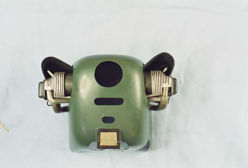

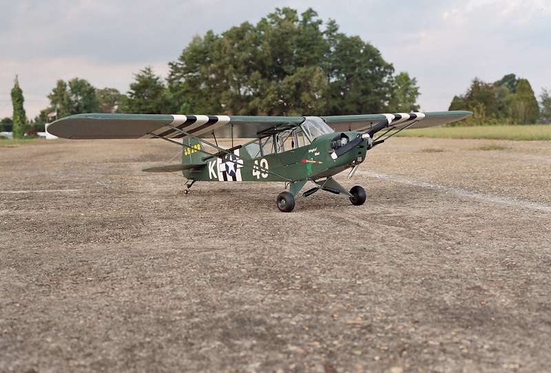

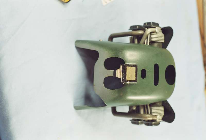

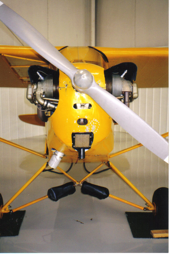

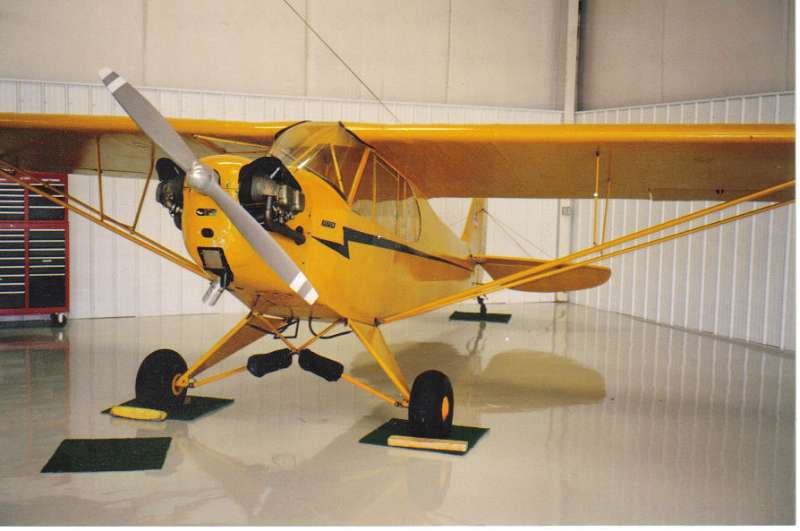

And a few more--The full size Cub belongs to Michael Waltrip, NASCAR driver. I got a bunch of detail from it. One other thing to consider if you do the J-3: it really isn't a great aerobat. The roll rate is slow because of the long wing, for one thing; you might consider whether you would want to clip the wings. It will still be a floater, but performance might be a bit crisper.

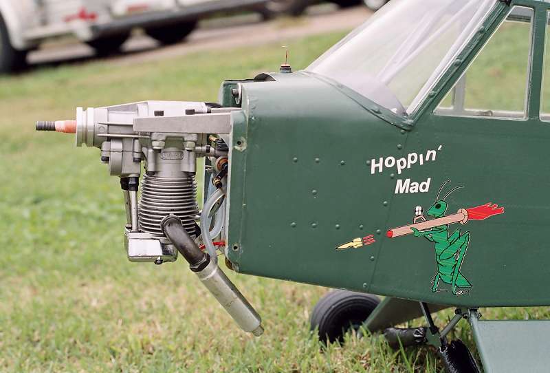

For a radio I am planning on the 9caps, which seems to be the best futaba for under a grand (the 9z or whatever was $1200 I think). I am almost positive it has several mixing functions. I'm going to wait until I actually get part of the plane built before I buy an engine. If a twin will fit, I would gladly pay the twice as much that it will cost, but the 1.60 or whatever is around 7 inches across, 4 deep, and 3 high, I think. Since I don't have a real mental picture of exactly how big this plane will be, I can not yet determine what will fit. It would be great to have the cyls out the side like the real thing, but I wouldn't want to have one real one and then two fake ones on the other side. I think that I could live with two real ones, but only because they don't make a 4 cylinder small enough. And Khodges, that looks really nice. I was actually thinking of doing an L-4 like that, but I then decided that since I have access to a real cub, I am going to make it just like that one.
BTW, nice nose art
Edit, I found a Saito twin that was 1ci. Can anyone tell me about this? Good power, reliability? Does it have the twin carbs, because I have heard that those are a real pain. Also, who sells them? They seem alright, the OS just looks so much more like the real thing, and it has twice the horsepower being only 60% biggger.
BTW, nice nose art
Cool-- the 9CAP is what I use for my L-4, and I think you'll really like it. You can do everything you want as far as programming for the Cub, it's a great radio. I use a 149 DP receiver, is PCM and a perfect setup for the Cub. The 9CAP system comes with this Rx and 4 of those servos, just nee to buy a 5th servo.

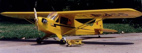

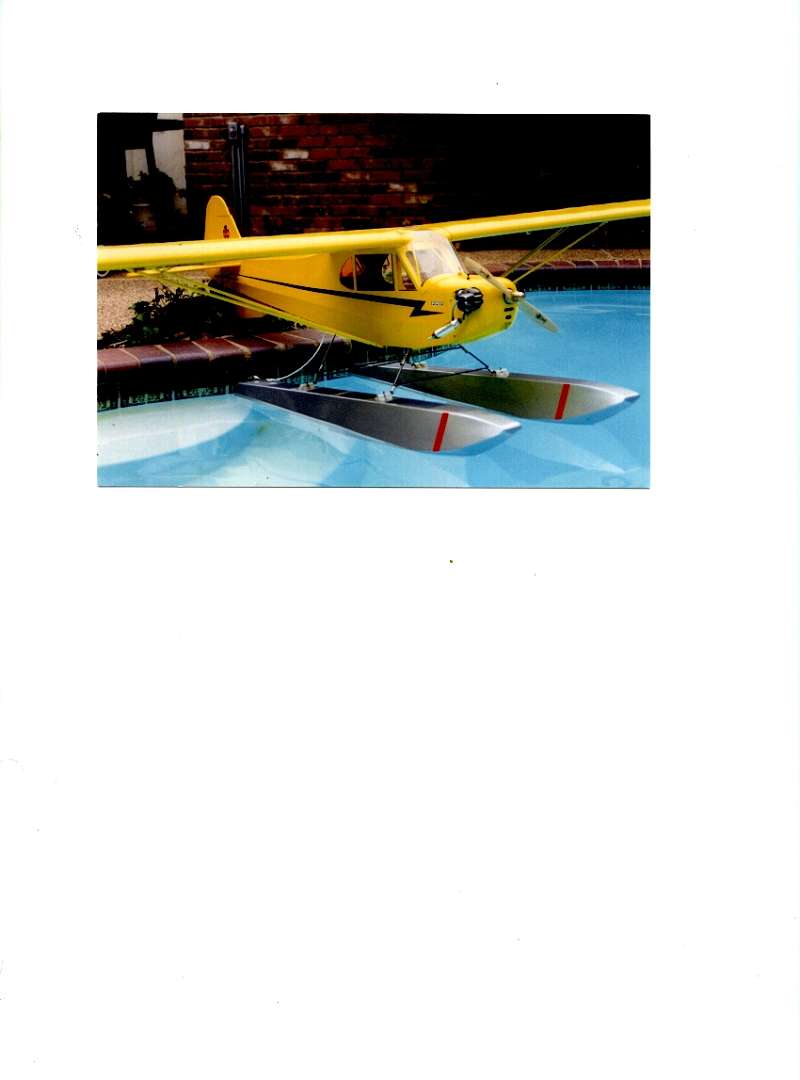

I'll throw in my 2 cents. I've had one for five years. The full wing is the most beautiful but most difficult of the multitude of airplanes I fly. It requires constant attention and will bite you in a second on takeoff or landing. The huge wing, short fuse, and short length make take offs a challenge. It ground loops in a heartbeat without constant rudder attention. I start wiggling the rudder before I start the take off run. I ease the throttle forward holding some down elevator to get the tail "flying". This gives good scale takeoffs. The other way to successfully take off is jam full throttle. That seems to get it up to speed fast enough that it doesn't change ends. I have seen the clipped wing version fly and looks like it flies like a trainer. So if you are not very experienced, built the clipped wing.
I have an OS-91 4 stroke in mine. Its a great match, especially if you put floats on it. I fly off the water a lot and I would not want any less power. It actually flies easier on floats. And it so graceful and pretty in the air. I guess all the weight hanging down gives it more stability.
I like the scale engine sticking out one side that is supplied with the kit.
Good luck,
Bob
