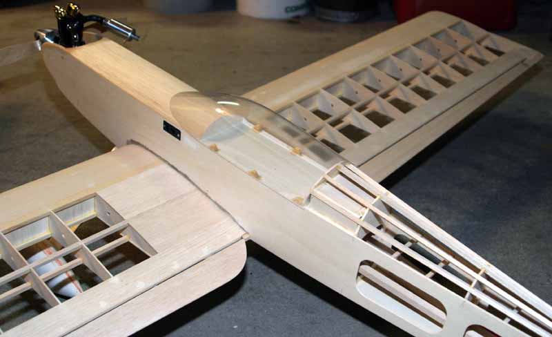

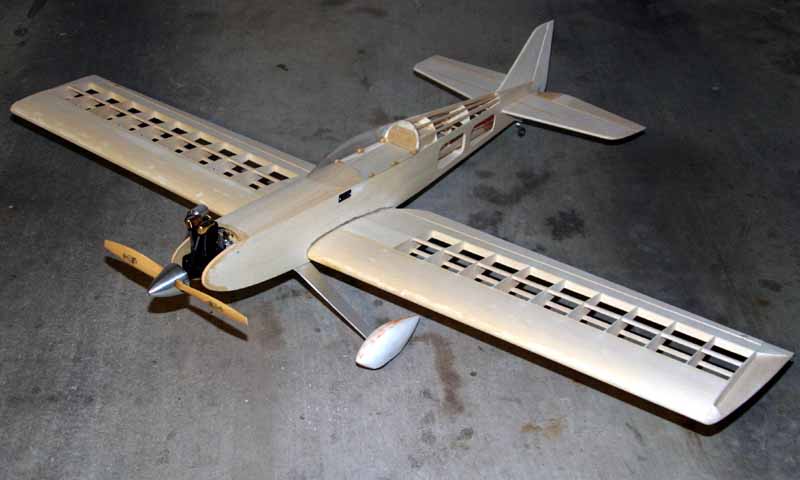

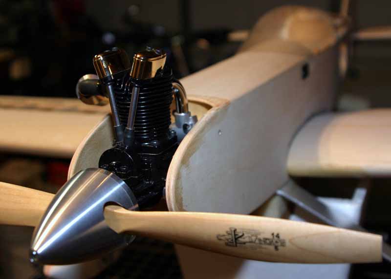

One of my favorite moments in building is putting it all together the first time before finishing.
Some of you work slow? I started this kit almost four years ago, built a few others along the way, and am now trying to get it finished before summer.
V60 enthusiasts can never see enough pictures, so enjoy. Those with a keen eye can note the little changes I've made.
Gary

Very nice job, looks well worth the time you spent on it. what size of saito did you use?
Dwaine

Thanks for the compliment. I do have a lot of time into it, but two other kits also got a lot of time while this one sat on the sidelines. I seem to average about one kit a year; can't wait to retire (only 20 years to go ) so I can bump that average up.
It'a a Saito 91 that's never been run. I bought it when I started this project, and now Saito's generous 3 yr warranty has already run out! Oh well; of all the hobby products out there, Saito probably concerns me the least. At least I know there are plenty of parts out there for this engine if I do have a problem.
Gary

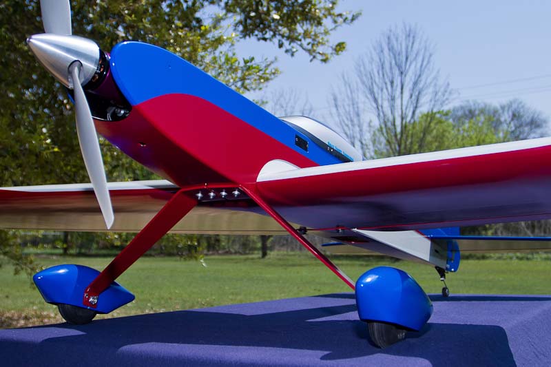

Wow - can't believe it was six years ago that I started this thread, and just now finished my Venture 60.
It's been a long path for this model. I started it in 2001 and originally set it up for a Saito 91. I then built several other models, and eventually decided to go electric with this one. The first flights were a dream - best flying model I have.
It's covered with Koverall and Brodak dope. I used a Hacker A50-14L with 8S lipos, controlled by CC Phoenix Ice 75. With a 16x8E APC prop, I only draw about 45 amps static, with over 10 pounds of thrust on the ground. Performance is spirited.
Finally, I can enjoy flying this one this summer and move something else onto the building board!

Hey Gary, pretty cool V60! Congrats on getting her finished. Hope you enjoy your flying season with it...
That canopy paint job really changes the personality of the model. I like it!
What was your final weight with batteries installed? What landing gear and wheel pants?

Thanks Bruce, Charles, & Airbus! I like the way the canopy came out too. The receiver and wire bundles are under it, so I knew I wasn't going to keep it clear. I had to come up with several schemes before settling on that one.
The main gear is the extended version that you sell, and the pants are from Fiberglass Specialties. I admit that I chickened out and removed the pants for the first flights. Good thing, as I ran it off the runway and into the plowed dirt once. I used a Sullivan unit for the tail gear.
The AUW is 9 pounds, which is much heavier than your design. The extra weight is primarily from the original build for the Saito (fuel proofing was already done), sheeting the leading edge, the fabric & paint, and a host of other little things that I like to customize my models with (e.g. the control surfaces are removable). Even so, it still flew like a dream and fits my preference for gentle sport flying very well. The extra weight will help flying in the constantly windy conditions we alway seem to have, and I found that I could stick it to the runway pretty easy without any floating. Stalls were gentle, straight, & much slower than my usual approach speed.
