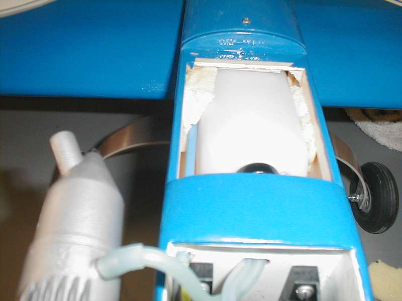

I am in the middle of building a SSE. I was wondering if anyone had any tips on mounting the top tank sheeting?

make a separate hatch "cover" for it instead of a permanent fixture. Saved me on my first flight. Clunk fell forward and I had to take the tank out/apart to fix it.

I made a removable hatch too. Much easier to get the tank in and out. Let me know if you need help and i will take some pics of it and send them to you.

I will try to upload the pics that FLYBOY sent me.
Victor
Looks like it worked
ID:	224788   Click image for larger version
ID:	224789   Click image for larger version
Old 02-04-2005 | 11:17 AM
FLYBOY's Avatar
My Feedback: (11)
Posts: 9,076
Received 7 Likes on 6 Posts
From: Missoula, MT
Default RE: SIG Something Extra Build
Heres a couple others.
I used a 1/8th in ply plate in front of the removable hatch on the plans. Shortened it 1/8th inch and put the plate in on the back side of the bulkhead as I remember. You could also re-build the bulkhead to include it and not shorten the hatch. Then I made the hatch over the tank out of solid balsa instead of trying to build it up. You could do that and hollow it, but I didn't. Just used a solid piece and sanded it to shape. Lip in the front goes under the front sheeting, and a screw in the back. You could also use smaller plates front and back and use 4 screws to hold it on instead of the lip.
Hope that helps.

I ended up doing the tank top sheeting just like the hatch top sheeting ie. by using some 3/16 square stock to make up for the bend that the sheeting didn't want to make.
BTW the manual suggests that making the tank top into a removable hatch will compromise the strength of tzhe front end of the craft ... up to you.
Also, consider that if you want a tank hatch, try putting one on the bottom of the fuse behind the landing gear. On my modified SSE this would work (though I didn't bother) but I checked before the fuse bottom was installed!)

What I did on mine was to dremel out the arc'd part of the tank shelf. I had already glued the cardboard tube in place. I was able to take enough off of the back side of the shelf that the tank drops down just as it reaches the carboard tube. Then it is just a simple task to tilt the back of the tank upward and pull it out. I made it easier by making a duct tape handle on the rear portion of the tank. That way I have something to pull on. It works great.
