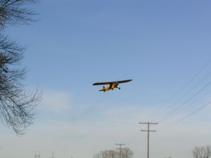

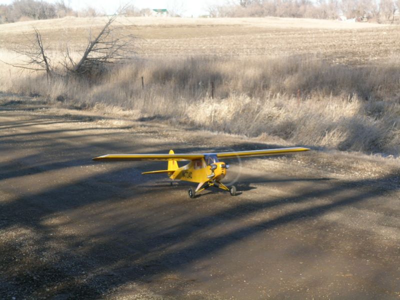

I finally finished my first kit (goldberg cub).After a month and a half, and many glued fingers i have a finished plane. I would recomend this kit to anyone for a first build. The weather was beautiful on friday so I decided to maiden it, it flew like a dream.

Looks great, buddy. Congrats.

Beautiful!

Looks really good for a first time but ah, heck how do I say this??? could you please put a pilot in it???? Airplanes have to have pilots don't ya know!!!!!!!

And your wing is too long (I like clipped wing cubs)
Other than that - Beautiful!!!

Thanks for the compliments guys! Now I wish I had built the clipped wing, rolls are very slow and its about impossible to get it to come down for landing. I plan on getting another wing set to build as the clipped wing (for flying off of land), and save the full wing to use with the floats i'm in the process of building.
P.S. And to GrnBrt I couldn't agree more on needing a pilot, it'll be in there as soon as Fed Ex drops it off.

Beautiful!!!
And a beautiful day for flying too.
Just watch out for those power lines!

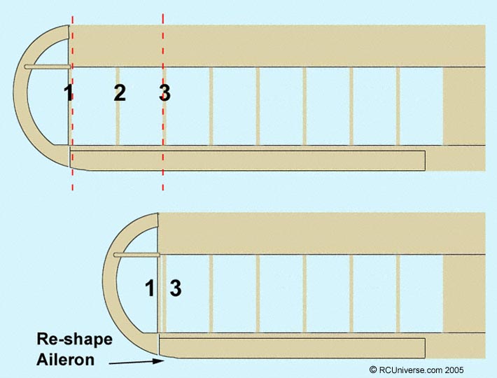

The clipped wing works just as well for floats. If you want to save a little time and money, you can easily clip the existing wing by just cutting two rib bays out:

Power lines on one side, and trees on the other [X(] You've got guts to fly there.

wait, theres dirt roads in brookings? hmm, might have to check that out when i come through this weekend!
