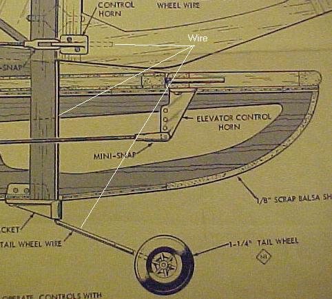

I bought a 95% finished CG Super Chipmonk. It has a tail wheel that is not connected to a servo. Can someone tell or show me how this is to be connected? The way the rudder is I can't see how I can steer this on the ground. Thanks

does it look like it has a control arm on the tailwheel? if so it should have a (2)springs going back to the rudder control horn...1 on each side. if ya look at some tailwheel pictures from a site that sells em ya will see what i mean. -tinman-

PieGuy, mine had the arm up through the fuse and out the back to the rudder (I believe). It is currently in storage but I will get it out take a picture of it. Post a reply with your e-mai address and I will try to send a pic.

mine also had a rod through the fuse and to the rudder

They say a picture is worth a thousand words...
-Bob George

Yep, Bruiser's got it, I did mine like that with no problems.

Thank you all! It was mounted forward of the rudder before. I'll pick up some wire and follow the picture. This really helps. Thanks again,
