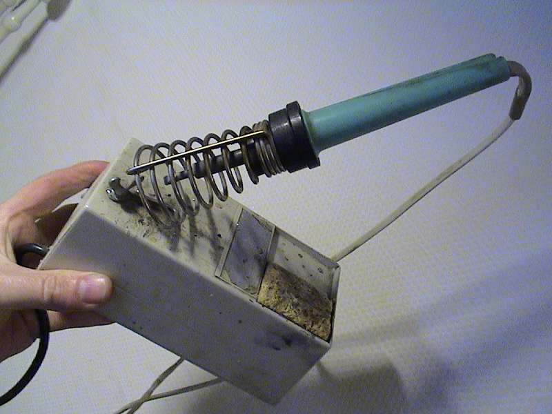

Hi!
Here is what you should get!
There isn't any better sweet solder available and the Weller 50W soldering iron that I have used for 30 years is good too, with its automatic temperature control and iron plated tips that doesn't need cleaning.
Regards!
Jan K
Sweden

Old 02-22-2005 | 11:43 AM
Posts: 7,769
Received 6 Likes on 5 Posts
From: FL
Default RE: What type of solder do you use?
Jaka, the solder you pictured is a silver based (very little but some silver) and is somewhat stronger than the electronic solder. However, it uses an acid flux which must be thouroughly cleaned after soldering or you will get a fair amount of corrosion later. For soldering such things as clevises and throttle connection, regular electronic grade solder is very sufficient and, with the rosin core, will not corrode, even if not cleaned off after soldering. Now, if you are talking about soldering landing gear (music wire) you will be better off using an acid core solder followed by a good scrubbing to remove any left over flux when the job is complete.
