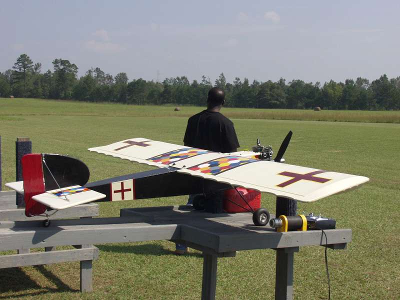

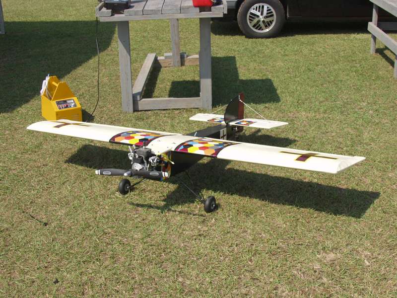

The Old Timer and the Bridi Stick are the same except for the name on the box and the lower right corner of the plans. I have both. I have one with a Homelight 30 on it. I wouldn't scallop the trailing edges if I were you? I did and low speed control is lacking. You will need to brace the vertical stabilizer to the horizontal one. The vertical is not anchored into the plane that well.
The fuselage is is huge, it could be narrowed up some and maybe not so deep? Cover it with Monocoat. You could cut holes in the plywood sides to lighten the plane? Hollow the ribs outboard of the center section? Use light weight wheels.
Mine has all standard servos but there are two on the elevators.
Enjoy,
Jim

I am planning on using williams 5 in. wheels plus thinner landing gear. I have altered the rudder to extend it 4 in. without adding more weight. Have drilled out the airlons also. Will lighten the fusalage by building a frame using 1/4 square, & just use the light ply for the saddle & rear ply for the tail feathers. Am using a homie 33cc chainsaw engine with a #28 carb. I noticed that yout engine is mounted head up. I have allways inverted mine. Any advantage to your way?

They seem to run the same either way. I just thought my spark plug may last a little longer if it was on top. I have the Homelite 30 with the 28 carb and it was a lot of power for this plane. It is not under powered even with the extra weight and the 21st Century fabric on it. The engine will turn a Dyna Thrust 18-8 at 7600 and idle at 1800.
Leave the landing gear with the 1/4" rod. You will need it. But use light weight wheels.

If you look at the picture of the plane taking off, it has a inverted G23 with a cowl like on the plans. It also had Dave Brown 5" wheels then. These wheels are cheap and light weight. But the foam has a memory and the tires get flat spots on them after the plane sets on them a couple hours and it will take 3 months for the tire ti even out again. If you look closely at the picture of the plane taking off, you will see a big flat spot on the back of the tire closest to the camera. I changed to Dubro Cub wheels and like them.
My plane with the Homelite 30 can jump off the ground in just a few feet but you will not have any control. You best keep it level until the speed builds up. Let it rise off the ground slowly.
The plane doesn't land like a .40 size plane. There's no ground effect when landing. With the engine idling at 1800 the prop acts like a brake. Keep a little power on until you get it level just over the ground. Then chop the throttle and let it settle on the ground. You can land the plane just on the mains with the tail high or you can 3pt land it.
