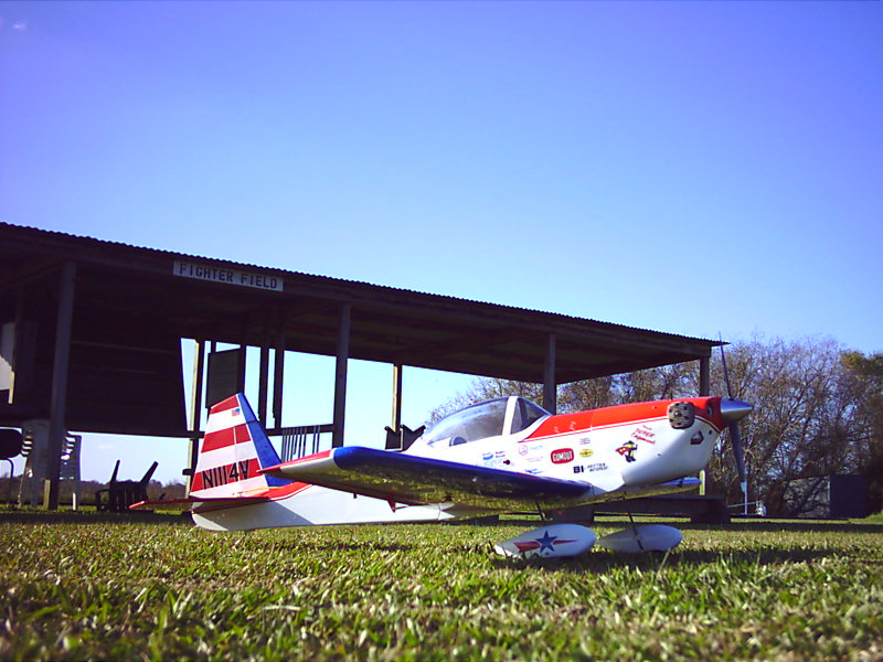

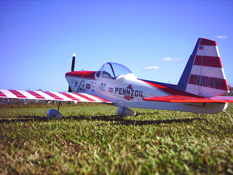

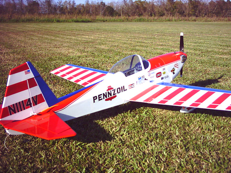

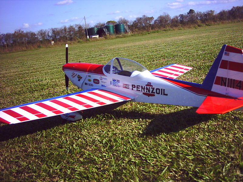

Plans say
1 5/8 on the fin and rudder
1 13/16 on the wing
I fudged a little on mine
I got my Penzoil decal a little too forward and too high. Beware of doing that. I think there is some optical illusion with the wing off that makes people do that. It seems rather a common mistake.

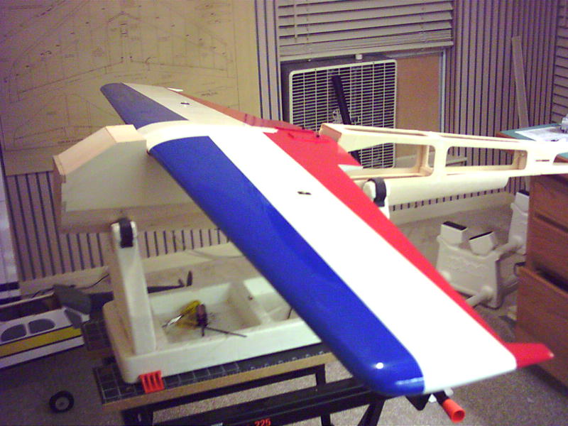

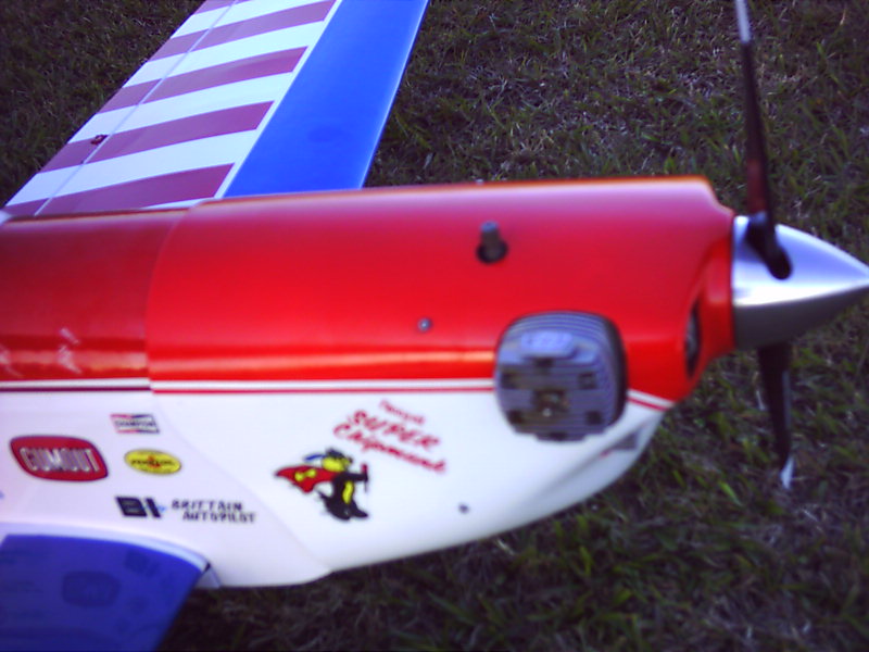

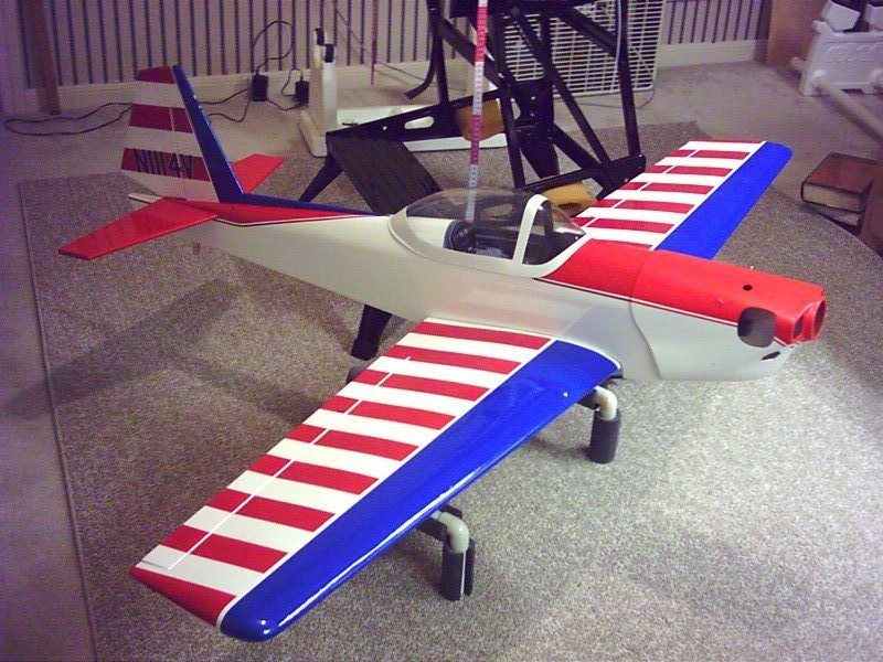

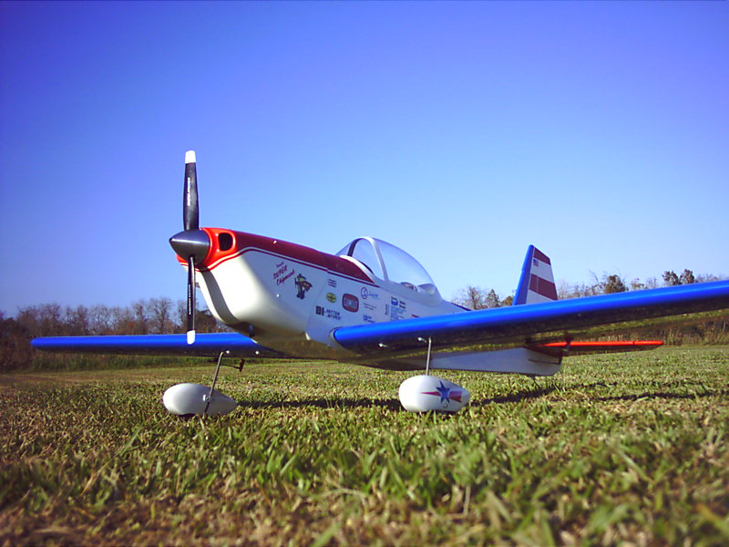

I left a white gap between the red stripes and the blue on the wing
And I left a small white space between the red stripes and the fuselage.
And I left the belly white.
