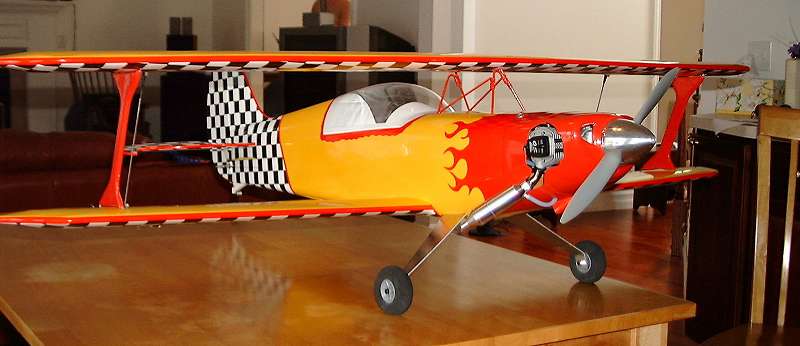

I have almost finished a GP Super Skybolt and now into the final balancing. I built per plans and sanded the heck out of the fus. knowing it was a heavy plane. I have a Magnum 120 up front. Problem is I need about a pound up front to balance it[]. Am I missing something here?? Have checked CG measurements many times, even with observers so I'm pretty confident about correct CG.
Any help and ideas would greatly be appreciated. Who knows how it will fly that heavy.

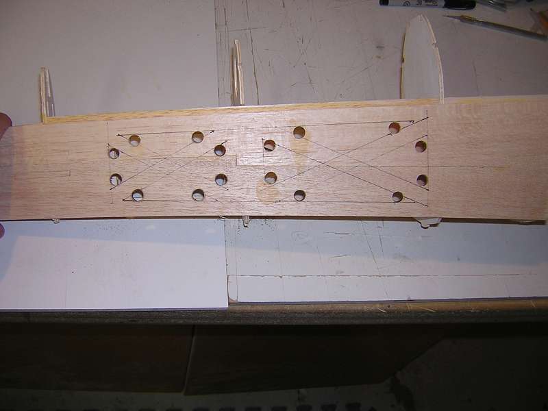

Had I not done my lattice work on mine, I'm betting I would've been in the same boat. surf, check out [link=http://www.rcuniverse.com/forum/Lightening_the_GP_Skybolt/m_2496934/tm.htm]this thread[/link] I started when I was building my Skybolt. I am also going with a Magnum 120 up front, and just started covering two nights ago. I managed to take 3.9 oz out of the tail, which translates into roughly a pound up front. With my RX and battery over CG, I need no added nose weight. It balances perfectly. However, I do have to add 1 oz in the right top wingtip (on CG) in order to balance the Skybolt laterally. My Magnum is inverted, and I guess I need to compensate for the off center engine, and the exhaust. I think a sideways mount would've been even worse, just on the opposite wing.

My plans show the CG just in front of the LE on the bottom wing. The lightening could still be done, just start out with small holes. I used the inner fuse doubler as a guide when I did mine. The fuse was built, but the turtledeck and the bottom corner pieces were already in place. Once you get one side opened a little, just use a long pin or something to poke through the other side to mark your holes. It's time consuming, but it will save you a pound. A whole pound, man!

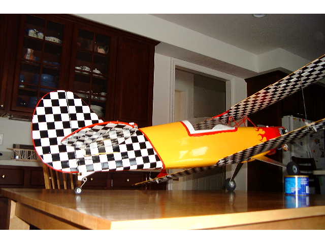

I don't have a picture of the top right now but the wing tops are the cub yellow, tail feathers all checked (matching checks by the way, I'll never do that again). If I get time I will take a shot from the top and post.

Pictures of the top.
