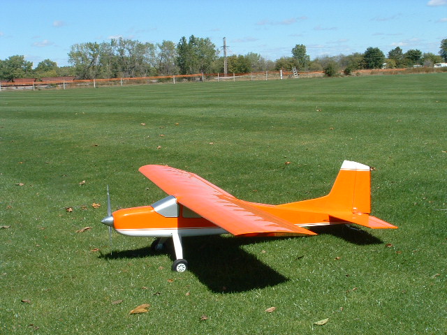

I have had about 12 planes since getting into this hobby about 5 years ago. My LT 25 build was easy and it flew GREAT and was one of my favorites. It had 3 owners since I had it and still going strong. I had my first engine.... a .40 LA on the nose and it would do almost unlimited vertical!! The LA is not a strong engine but the plane is so light that the LA is a great match. I flattened the wing with no more than 1/2 in total dihedral. Other mods guys gave were good too. As far as the wing tips go....... AND THE FORMERS TOO...... they can be fragile. The formers are BALSA. There is very little lite ply in this kit. (that is why my .40 LA kicked butt). I build "heavy", and still this little jewel came out at only 4.5 lbs!!!![8D]
My advice, 1. Put some gussets and bracing in the wing tips and flatten out the dihedral. 2. I hardened the formers, AFTER installing, with CA. They are very weak since they are balsa. 3. IF you use dowels and bolt-on wing.... be SURE you put PLENTY of added strength on the former where the wing dowel (s) will enter. Lite ply doublers and soak in some CA to the former in general.
I was trying to learn some aerobatics and did not want to sacrifice my 4* 120 if I messed up. This LT 25 helped me try new things. It is not a true aerobatic plane..... but it did a GREAT job helping me learn the basics and it was a lot of fun flying this plane..... lownslo

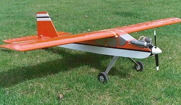

All the above mods are good ideas. I left off the wing tips as well, I just think it looks better. A one inch tailwheel looks nice on it as well and helps on grass fields. If I were to build another I would use bolt on wings rather than rubber bands-this plane is just to easy to fly to worry about bad landings. And like stated before dont be afraid to beef things up a bit if you like, it can handle it no problem. An OS 40 La with a 11-5 prop or 11-4 makes nice slow landings a thing of beauty. You made a good purchase with this airplane have fun!

[&:]As good as the LT-40 is, the 25 is even better. Its almost all balsa with just a few lite ply pieces, so this thing builds really light. I tend to overbuild by adding extra beefing up like triangle stock and landing gear plate area etc., but its still comes out very light. This plane will fly even slower than the 40, and can manuever better than the 40. I left my wing with the stock dihedral because I think it looks better with it, and I just wanted a mellow flyer rather than a stunt plane, even still it will do some basic stunts rather well. If you do remove the dihedral it will improve its self correcting manner if thats what you want, but if I were you build yourself a Tower Hobbies Up-Roar 40 for that -crazy fun! And leave well enough alone. One nice thing you might consider is making the wing a bolt on, not very hard to do if your a confident builder. Also put on some decent spring axles on the landing gear rather than the crappy bolt-washer-nut method that they have on the plans, yes it would work, but they are a pain as they tend to loosen and rub the tires. Have fun!

As long as your glue joints are well covered you should be OK with a .40. I have a Thunder Tiger .36 with a 12x4 prop on mine. This works as I don't need instant accelleration and usually fly at 1/2 throttle or less. I have the modified bolt on wing as well as many other changes to bash it into a Cessna 185 well sort of.......

GarySS.....What a nice job you did on that LT-25. Yours is about the same color as mine, (post#7), but you did a real good job on exterior mods!!! The nose looks fantastic!! .......lownslo
