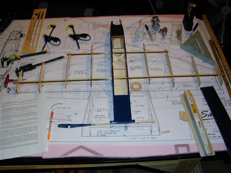

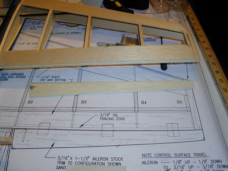

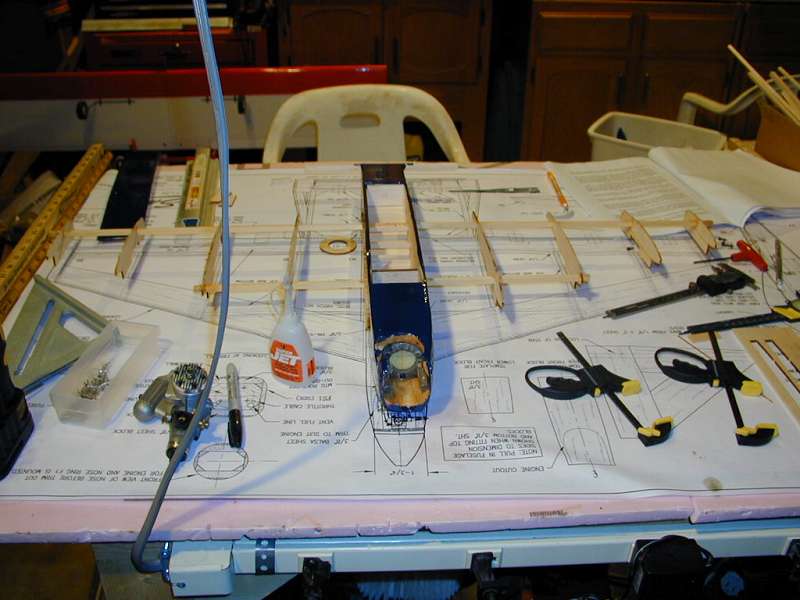

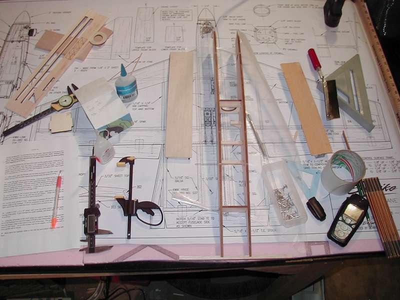

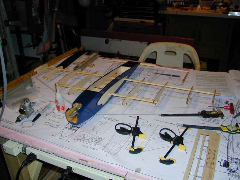

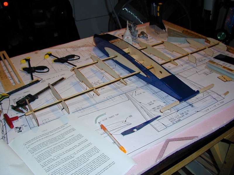

Here are the latest photos. The blocks are in the nose. I have sheeted the top and bottom of the Fuse. I have begun to shape the nose. It appears that the F1 ring for the nose is not going to be used since I will not be able to glue it in place, and then mount the engine. I prefer not to mount the engine and then glue something in and make the engine inaccessible. The engine is filling up the nose to the point that it will probably not be rounded, but more of the oval shape seen in the picture.

Fubar,
This is the .10 size Shrike from Tower Hobbies.
Alpha,
What did shipping cost you to get those to New Zealand? I don't understand what you mean that you have four models on the build from two kits. Taking the new guys from a trainer to a Shrike is going to be a serious step. The build isn't the issue, although good building habits are required. Its getting used to the aircraft.
With a .15 size in my first shrike I was able to handle things fairly well. The biggest problem is prospective. Many times I had to make a move with the sticks to see which way the model was going. Since this little dude goes where it is pointed, and in a big hurry, a person who becomes disoriented might freeze a little to long trying to figure out what is happening. I have seen some people solve this with making the top and bottom very different colors. I find this unattractive. We intend to initially build at least two in the Blue Angles color scheme. Another very nice thing about the smaller engine is weight. This thing will really come in with some beautiful nose high landings with a light wing loading. This aircraft will have an HB .25 crammed into it along with a 6 ounce fuel tank. I anticipate placing the battery in the tail to compensate for the nose weight.
The wing structure is designed to be light but sturdy. That is as long as you aren't over powering it! I am replacing the spars with Spruce reenforced with Carbon Fiber strips. It was a spar failure that took my last Shrike. The spar failed at the wing root.

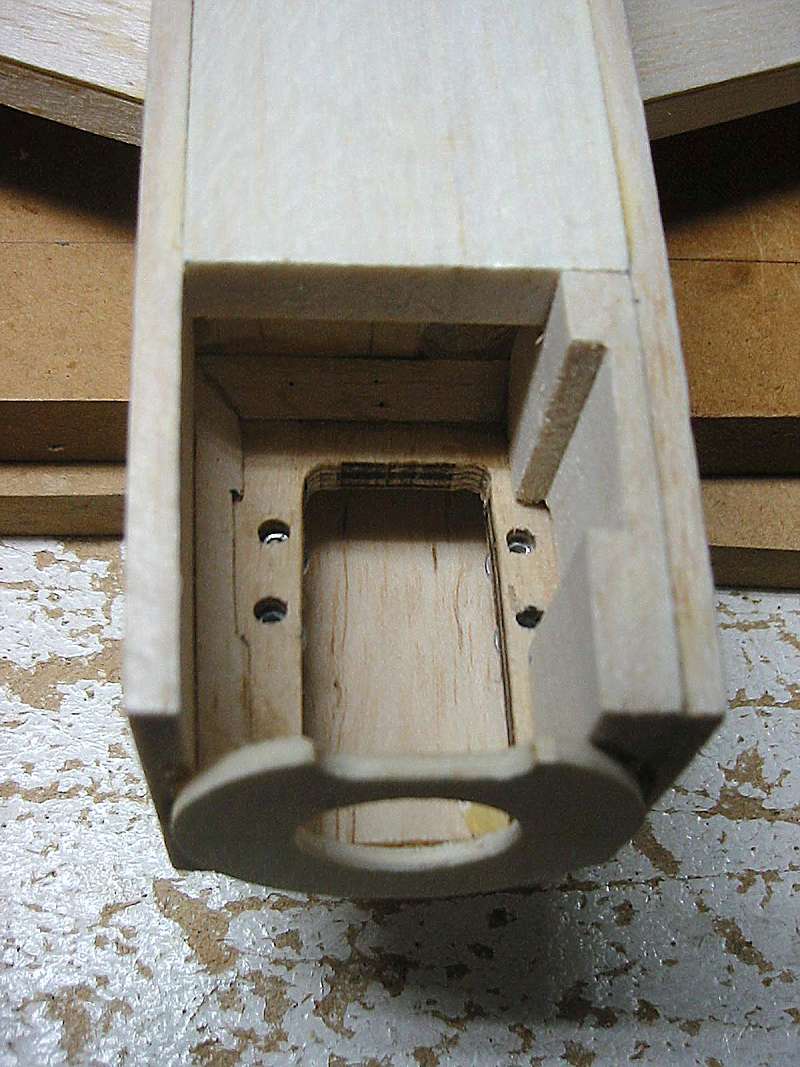

I got the engine thing wrong in my previous post, sorry, finger trouble. We are going to use a mix of OS .10 FSR and .10 LA`s in these. I bought these kits from Omnimodels in this instance, better special discount than Tower at this time although I understand the dough is all going in the same pocket? The kits cost $32.99 each ex stock over there and I ordered one or two other items with them - total freight charge - not cost - $63! Is it any wonder we mostly design our own.
Four models from two kits? Easy. I photocopied the laser cut items and two of us are going from scratch. My one photographed here is one of them.
Note I have fitted the additional wing spars here - turned out to be 4mm square. I have since glued the lower LE sheeting in place and will apply 4" wide x 1/16" shear webs tomorrow.
Also pictured is the engine bay. I made up a 1/4" plywood plate for this engine mount. The little OS.10 FSR fits in there quite nicely. I`ll shape all this for a 2" spinner further down the track.

Alpha,
An OS .10 FSR? Now that is a nice engine for this little plane. That will be a noticeable contrast to the .10 LA engines. I believe my Kiwi neighbors would say one handles like a porche and the other a Yank Tank. That's a nice shot of your engine compartment. Nice and clean. It should shape up nicely.

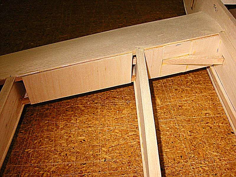

Here`s a couple of shots of the shearwebs. They have certainly stiffened the wing, although not probably critical with the planned OS 10 FSR installation. I packed all round the spar in the first bay with 3/32 sheet; the other bays got 1/16" placed vertical.
I am conscious of trying to keep the weight down. As shown here the assembly weighs 7 5/8 ozs

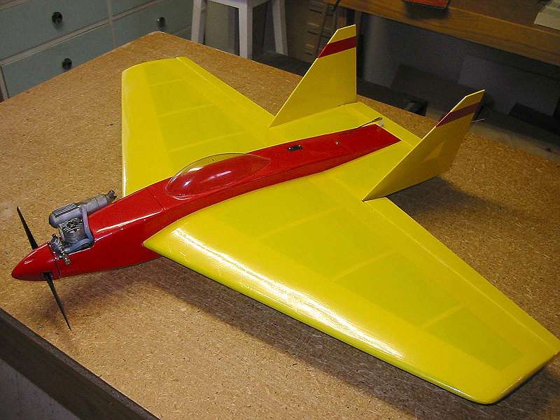

Hi guys,

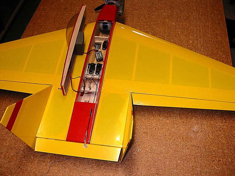

Here`s my one all finished and ready for that first flight. Midwinter down here at this time and has been raining like crazy for the past 2 days - I hope it lets up for the weekend.....
Basic details are:-
OS 10 FSR engine ( I fitted a muffler ex OS 10 FP as the pressure nipple faces the right way)
Futaba R114F Rx and 3 x S3101 servos installed.
Covering is 'Easycoat'. Underside is all dark blue to provide a contrast from the topsides. also, I ran out of yellow - it`s all leftovers from previous models.
All up weight ready to go as shown here is 26 1/2 ozs.
I had a problem trying to decide where to fit the switch and eventually settled for on top of the hatch. The hatch is screwed down at the rear otherwise I would have put it inside the fuselage.
I`ll let you know how the first flight went in due course.

Hi Bob,
First testflight last Wednesday was almost its lkast. Too much aileron, not enough elevator, CG too far forward, and too windy!
Just got back from our regular Sunday morning session less than an hour ago and had four flights this time after making the corrections. Now 1/8" aileron each way - could use a fraction more, and a little over 1/4" elevator each way. I shifted the nicads back to underneath the aileron/elevator servos to get the CG right. It`s a lot better now.
I flew it mostly in tight low circuits, much like we intend to do for some low-key fun pylon type racing. The boys loved those long loooow beat-ups with rolling vertical climb out at the end and can`t wait to get started.
This sure is a fun little machine now. Every hoon should have one!
Alan W

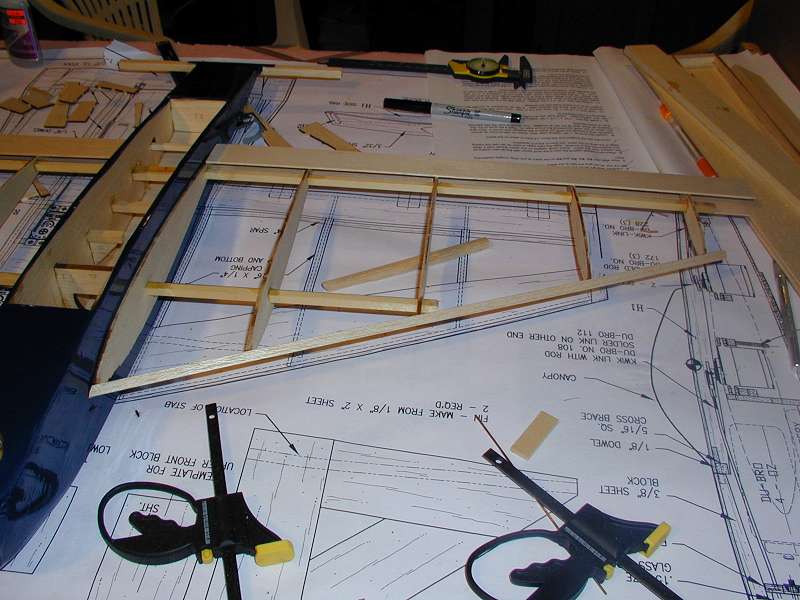

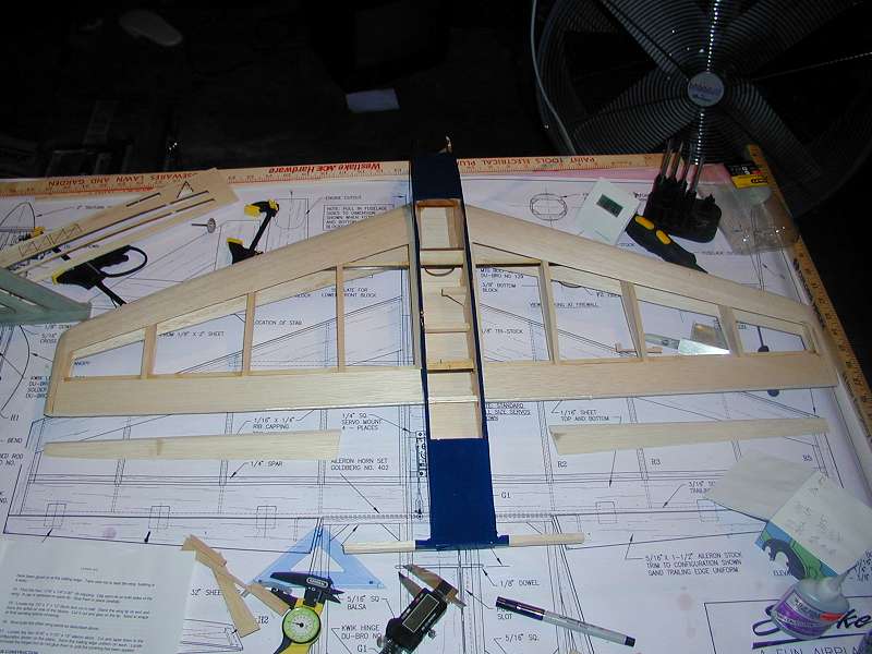

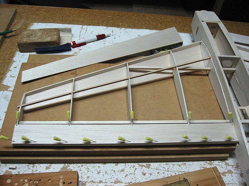

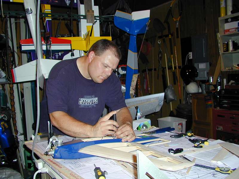

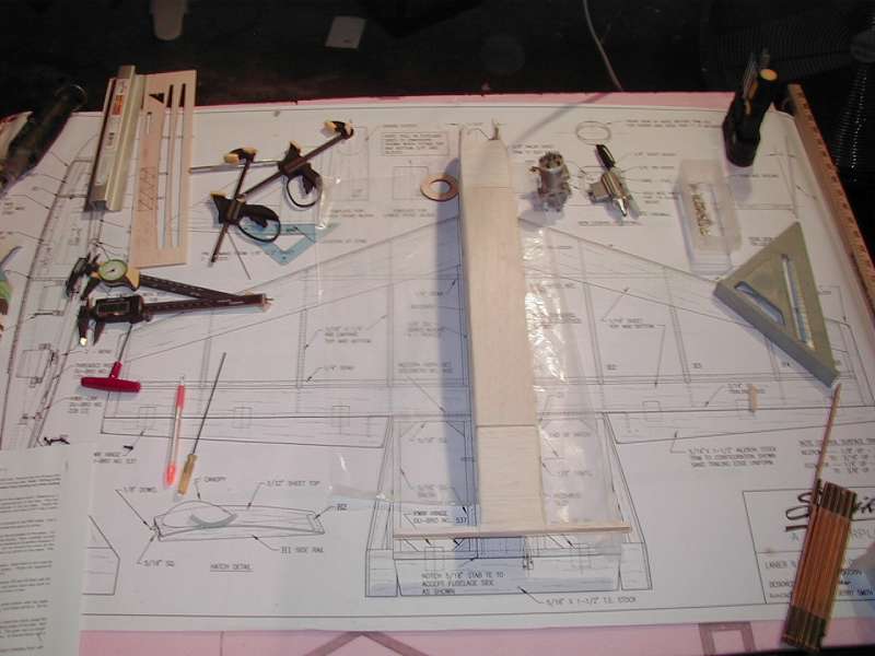

Well, I got a little more work done tonight. You got me motivated AW! We also flew today, the wind was very agreeable, but after storms yesterday, we had about 60% humidity as the temps got to about 95 degrees F today. Hot and Muggy!
Tonight I got the wings finished. Here are some pics. Someone at Lanier should be shot for this aileron design! Yes, I sanded the the ailerons to shape from the blocks provided.

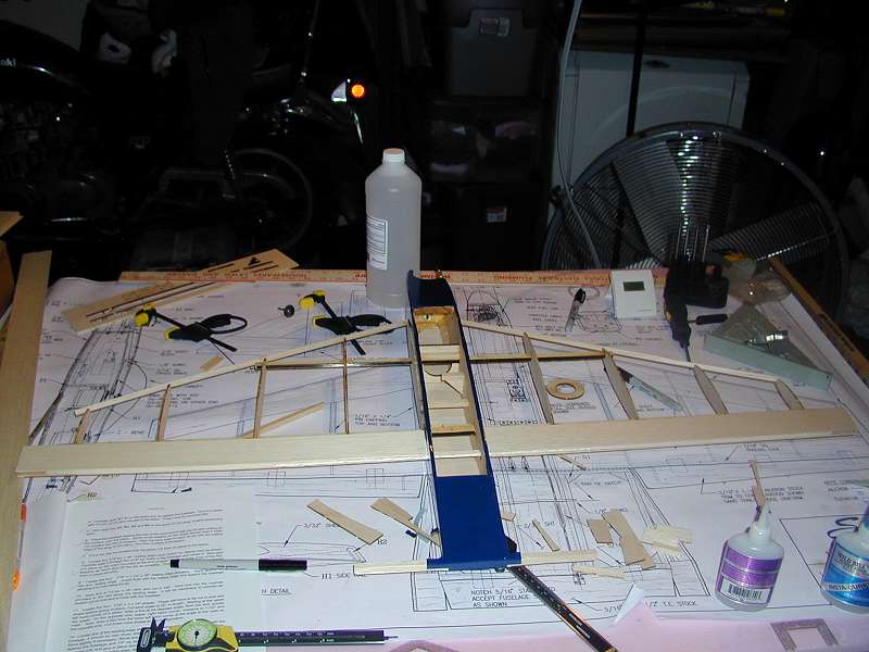

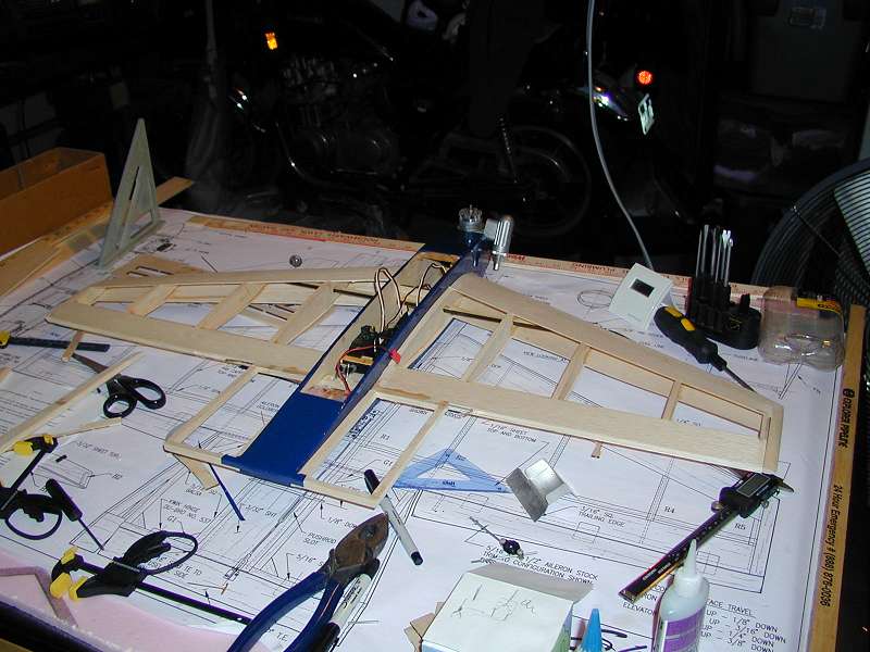

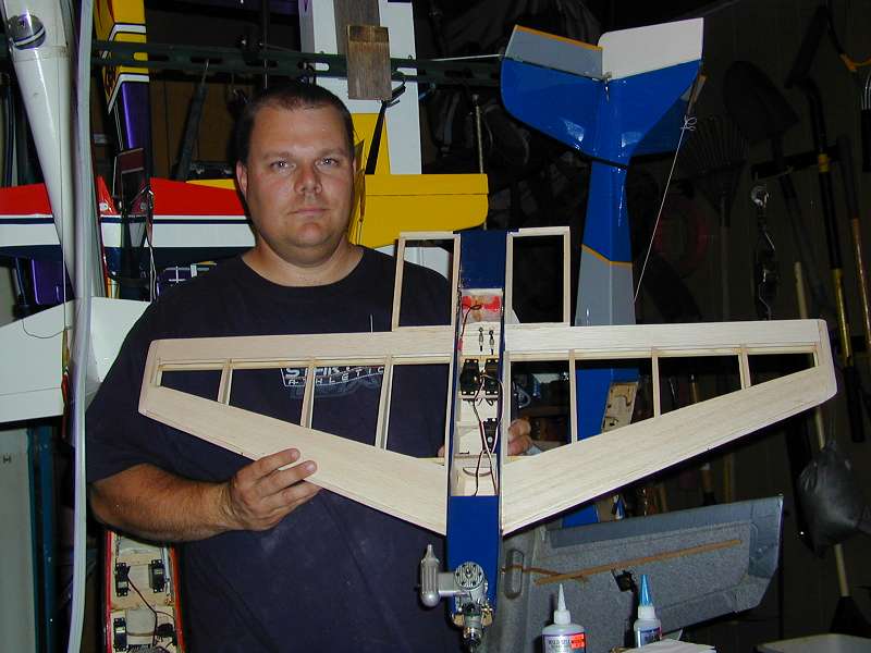

Here are the pictures with the stab framed up. Also a shot of me fitting in the servos. I am going to have to add weight to get the tail to get this balanced even with the battery as far aft as I can place it.

Hi Bob,
That`s a busy workshop you have there! In my experience, the CG position is most important. I had not flown a delta prior to this and was keen that the CG would not be rearward. As it worked out, too far forward was pretty exciting too. Anything less than about 7/8 full power and it was in a shallow dive, even with up elevator!
For he first landing I did a flatout low approach and just cut the throttle. It must have skidded for about 100yards along the deck but luckily nothing came apart!
With the CG on the spot shown it is quite OK.
On the covering. For anyone out there about to build one of these, note that Bob has the fuselage covered already. This seems to be the better way to go. I did the same and pleased I did - it seems to be the easier sequence than wings first.
Good luck with your project.
Alan W

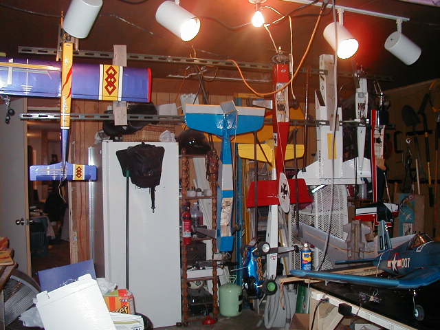

I really like my workshop. I would like it more if I had climate control, but we can't have everything. I have a 9 foot long build table in the middle of the garage, with a 10 foot tool bench and storage area behind it. My motor cycle occupies the other side along with the obligatory storage area for the wife. At the head of both benches is the fuse rack and a wing storage area. Oh, and suspended from the ceiling is a 4 by 8 Nscale train layout. I haven't touched it since I got serious about aircraft about 3 years ago.
Currently, I have 7 aircraft including the sonn to be completed shrike that are flight ready. I have two kits that are still waiting the build. The next is the Ziroli He-162 Folksjager, and a Sterling Spitfire. I really want to build another Corsair. The last was an ARF that had a twisted wing and was simply not safe to fly, nor realistc to repair.
