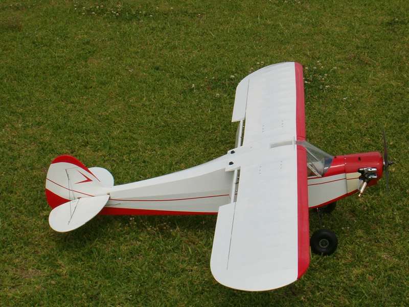

has any one ever built the old 71'' piper cub
if so what did you power it with
would love to see some pics too !!!!!!!!!!!!!!!

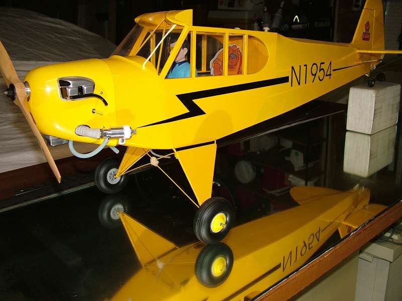

I have built a couple of them, do a search and you will find some threads. It is a great little plane, but a real builders kit. I used the OS 40 4s surpass.

thanks for the pics looks great did you have any probs puting the 40 in i have a old saito 45 but on the plans it dont look like it will fit might try the new satio 40 looks alot smaller than the 45

What I did to fit in the 4stroke was to shorten the nose of the aircraft about 1 1/2 inches. I just kept the same prop location as per the plans and the cowl was plenty long enough. The ballance worked out to be perfect. The first one I built I used the early model Saito 40 with exposed rockers and it was plenty of power. This plane will fly with a 20.
