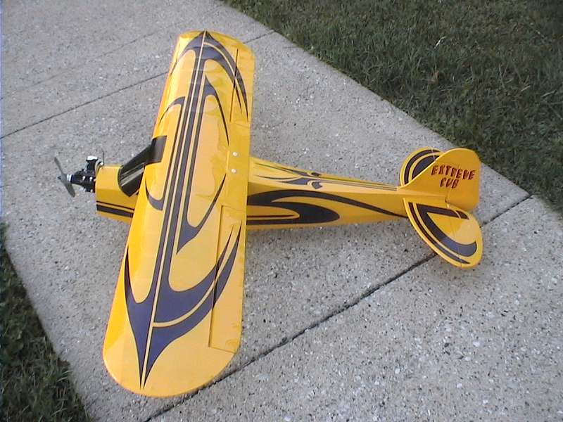

Well after many months of building, my first kit is done! (Except the cowling) the kit is a Great Planes 40 sized Piper Cub. I mounted a Saito 65 GK up front for power. I installed a TME smoke system as well. I painted the cockpit windows black to hide the plumbing, tank and pump for the smoker. With everything mounted as far forward as possible the plane balanced at the recommended 4 inches. I also clipped the wing to give it some more zing.

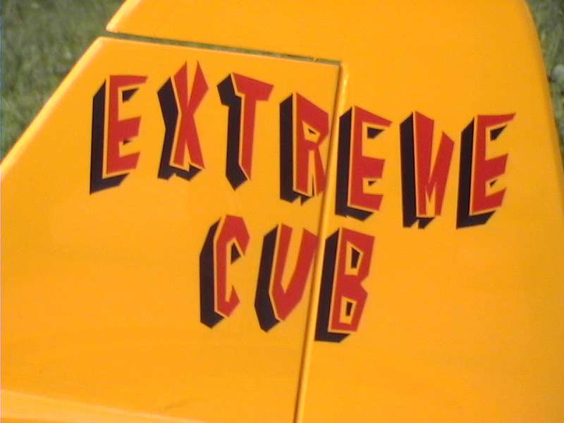

I did not want this cub to look like any other cub, so I made a complete set of custom vinyl graphics for it. It took me 5 hours to cut and apply the vinyl. I named the plane "Extreme Cub" and applied a Angry Bear (Cub) on the underside of the wing. Well, let me know what you all think.

I had the fairings installed but their leading edge did not line up correctly with the leading edge of the landing gear. They were angled back and looked silly, I removed them so I could reshape them. I chose not to use the wing struts because I have watched other club members arrive at the field and mess with the screws to install and then have to remove the struts before leaving. (Tiny screws are hard to find in the grass ). I suppose if I had kept the cub scale, I would have used them. The build went very well, I would have to say that the only difficulty I had was trying to join the wing halves. This kit used 4 or 5 pieces to join the halves together, I ran out of clamps while I was joining them together. I really thought that I would have most of my problems forming the wing tips, but that proved to be quite easy. I have to thank my friend Jason for helping me apply the Monokote. As soon as I get the engine running smooth and consistant I will install the cowling. BTW I broke the engine in with an 11x8 Zinger prop, just like Saito suggested. But it made this Cub zoom way too fast. I ordered some 13 x 4 APC props, while I wait for them to arrive, I am going to use a 12 x 6

I like your custom graphics. Exactly how do you do that?

Talk about hooked on this hobby! I purchased a 24 inch plotter/cutter just to make graphics for my planes. I invested about $3000.00 on my system. I simply layout my design on my computer screen, send it to the cutter, and voila! Instant graphics. It is sooooo convienient!
