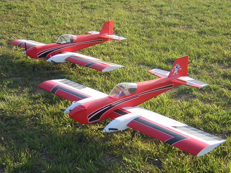

Ward, I bashed my coropast Four-Star copy into a bipe last year:

Excellent : thanks for the pic! What is the forward set of the top wing ( leading edge to leading edge) distance and measurement between wing?
How does it fly? What engine?
Thanks Ward
Old 07-26-2005 | 01:15 PM
Deadeye's Avatar
Posts: 4,516
From: Dutton, MT
Default RE: 4-Star 60 Bi-plane
Top wing is set 1 1/2 ahead of the bottom wing. Both wings are swept back 3/4 inch per side. Distance between wings is the same as the chord. Engine is 75 Tower 2 stroke, AUW is 11 pounds. She is a bit heavy, but she flies nice. It tends to 'search' at high speed, but lands like a dream.

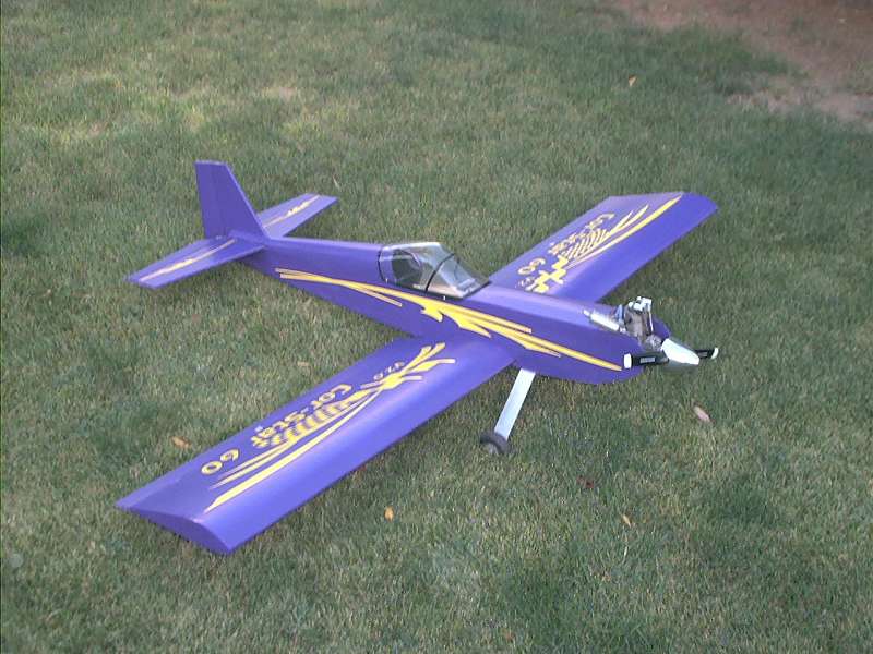

Not exactly. It is a coroplast copy of the Four-Star, named the Cor-Star. Purple one is the original, then the bipe above, and the second picture here is the twin version. Same dimensions as the Four-Star, identical tail and fuselage, etc. Do a search for 'cor-star' here on RCU and you can read all about it.
