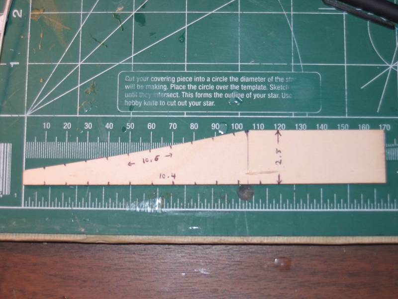

Hello all, In reprogramming my radio last week, somehow I messed up the centering point for the ailerons on my Sig Somethin' Extra. The manual says to use a Aileron Position Guide (AGP) that they provide with the kit. Well, wouldn't ya know, I can't find the one they provided. Can anyone tell me where teh neutral throws are for this plane.

I believe that the aileron neutral point is parrallel with the thrust line instead of the top of the airfoil. I am away from the house right now, but I will check my se later tonight.

Do you still have the manuel? If soo look at the parts sheet and copy it and cut out a new one.

Here's a picture of the guide. All marks and dimensions are in cm.
Hope this helps.

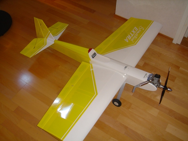

Default RE: Sig Somthing Extra Aileron Center point
CG depends on what engine you have planned.
I use a OS .70fs and it's nose heavy... I have servos & rx in stock lockation and a Futaba 1500mah ni-cad under the servo plate.
It flies great, but I can feel it's nose heavy and needed to trim some elevator to compensate.
I will play around with the battery and/or weights to get the CG more back.
Instead of messing around wih new servo locations, one guy in our club who also fly a SSE with 70 fourstroke has made a battery hatch behind the canopy.
tyhoc: That's the spirit! Very nice of you to take time and post a pic of the APG

Sure, I have no eperince moving the servos. I guess another good thing with that is shorter pushrods and a closer link to the elev/rud surfaces.
The .70 is plenty power for this plane... But fun
ps. I have put a higher landing gear on my plane to make room for a 13x6 prop.
