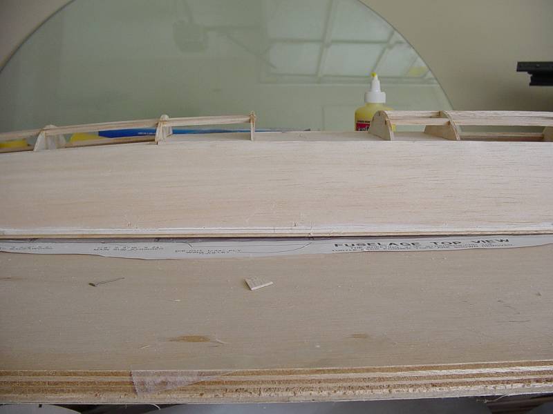

I've made a little progress since I posted last. Here is where I am so far. I'm getting the hang of sheeting. I thought this would be a lot harder than building my Easy Sport, but its not that bad. I'm already thinking of what I'm going to build next. Probably another Top Flite kit. They seem to be made for the non expert modeler in mind. I went out and got a hollow core door. Thanks for the advice on that. I would like to know more about the ceiling tile. It seems to me like it would be too soft. Does it really work? I'll post more soon.
Mike

Now there are a lot of different kinds of ceiling tile out there. I used the thick 1/2 inch ceiling tile that you find most commonly hanging in stores and in resturants. It pinned down fine for me, but I had to screw it down to the door to make it flat since it bowed a little. A little note on building the wings. If there is a little twist or if the wing is just not right an 1/8 inch or a little more do not worry about it. It can be trimmed out later in flight. Mine was around 1/2 or a little less off on the dihedral and it flys great. I used a supertigre .75 with a slimline pitts muffler (http://www2.towerhobbies.com/cgi-bin...?&I=LXFG90&P=0) and had to adjust the engine mount a little to allow for the muffler to go straight out the bottom. It sounds sweet. I get a lot of comments on how it sounds better than a four stroke. I had to cut a pretty good bit of the muffler off to get it to fit correctly. I would post pics but I cannot get my friend to get them off his camera.

As far as building surface goes, I currently use a 3'x 8' peice of modular furniture desktop that was surplussed from work. It is dead flat and really heavy so it doesn't move around. But to build on, I got a sheet of 1/2" of the pink builders foam (what they use to sheet the sides of houses) and secured that to the board. It works really will and doesnt' crumble like ceiling tiles can.
