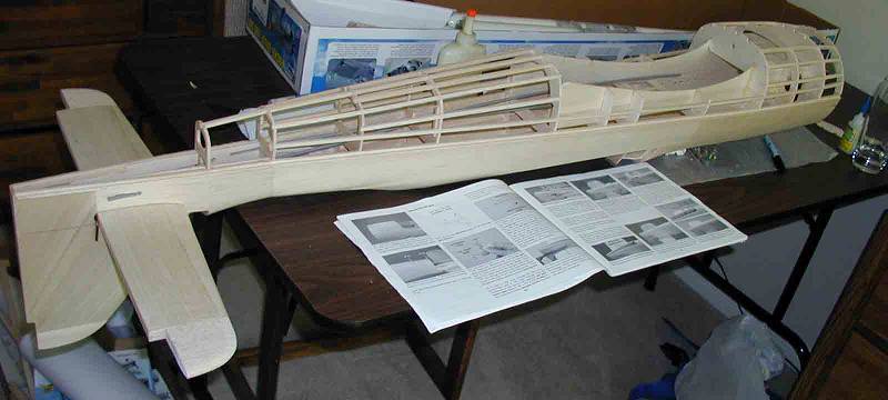

Well here is my top flite 190 build so far.

Jeeze I really need to clean up my work space.

I think I see a plane under there.
Those TF Gold Edition warbirds are terrific kits. Your FW looks good so far.

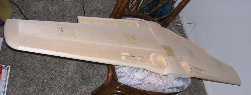

Going kind of slow, but Ive almost finished the wing now.

Old 01-12-2006 | 11:47 PM
Joined: Feb 2003
Posts: 1,244
From: Toronto, ON, CANADA
Default RE: top flite
looking good. bet you finally feel you're accomplishing something when it finally starts to take shape.

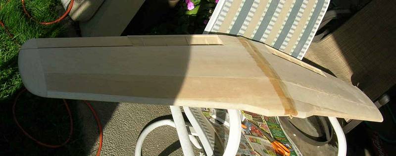

Thanks for the compliment.

Finally starting to see the light at the end of the tunnel.

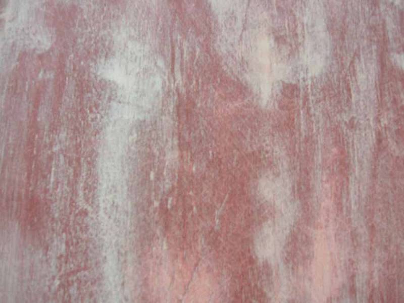

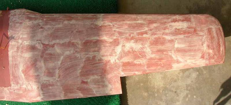

Thought I would try a different technique for finishing off my model. I used a wood sealer, then shot the wood with a sandable primer. Next, I gave the primer a quick sanding, then used a slightly watered down wood filler to fill in the grain and other defects. Finally I gave the wing another quick sand. I think this should give me a smooth painted finish without much weight.

Ok, I finally got the top of the wing completely prepared for paint. The second picture has the chemicals I used to get the final finish, if anyone is interested.
