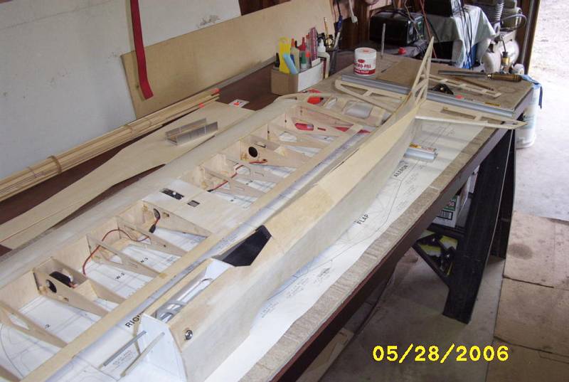

Hi badger: Sounds like you have had a few rough experiences with this plane. Hopefully, that is past and you can enjoy it in the future. What is the "fix" you are talking about in regards to the nose gear? Want to know in case I have that experience.
I haven't had much time to work on mine. All control surfaces are complete, the fuse and wing are now complete. I installed the upswept tips with screws from the outside
in case I get some hangar rash. I have also added a 1" wide strip of balsa from leading edge to trailing edge where the tip joins the wing. That way I can cover the tip installed
and have a "grab" site. I will cover the tips going out onto the wing( the 1" wide strip) about 3/4" on this strip and then when I cover the wing I will overlap it about a 1/4". If I have tip damage later, I can merely slice the cover down this added strip, remove and rebuild the tip and go on.
I have cut and installed 3/32" balsa from former F-4A (rear of canopy) all the way to the tip of the plane out over the horizontal stablizer on both sides.
I have the alieron and flap servos installed and the engine and receiver/battery compartment fuel proofed and painted with with LusterCote.
I am going to completely assemble the plane with all equipment, then laterally balance it and then remove whatever is necessary to cover.
I will post some pics tomorrow of the progress, so far. I have taken the pics, but the batteries in the camera need to be replaced before I can download then to the computer.
I have really enjoyed the flight reports you guys have been giving. The cowl is coming. I have the big block temp glued on and have
routed out the side pcs. so my .61 will fit. I wish they had come up with a fiberglass cowl for this thing.
Do any of you know where I can purchased some aerodynamic covers for the aileron servos?

Spotter, that is a terrific looking Contender. I really like the way you did the cowling. I can't tell from the pics, is
your engine sideways or inverted. How is the cooling? Did you assemble the control surfaces and then cover?
Attached are some pics of my build, thus far. I extended the rudder, going straight down and added 1/2" to the width
of the ailerons at the wing tip end. I am going with the upswept tips, as you can see.
Tell me a little about the flight characteristics and what size engine are you using? I am using a .61 OS FX.
Great looking plane and I like the scheme. Mine is going to be bright yellow on top, with 1" yellow/black
checkers on the bottom I am going to add some black and red striping is various places. I am not too far
from covering. I want to complete the plane, assemble, latterally balance and then dissasemble and then
cover. This will be my first real covering job. Will be using UltraCote. My first build in 45 years or so.
Used to build control line with silk and dope as a young teen.
I would appreciate any tips you might have for me. Let's hear the flight reports.

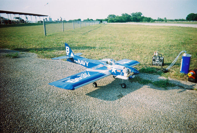

Thanks Neighbor to the East. My OS .61 FX is mounted to the side, built up balsa enclosed, using a plywood spinner back plate and balsa blocks forward of the firewall. Old RCM article. Much nicer than a screw on plastic cowl. And fun to make. 5.5 pounds using Titebond and epoxy. No CA. Monocote insignia blue and white. Balances with the battery behind the pilot.
Cover stabs, all control surfaces, then attach. Assembly and gluing hinges should be the last part of assembly. I bought Harry Higley's book on film covering. Perfect instructions for this plane. Great technique on covering those wingtips. Cover them first, in pie-shaped pieces. Don't forget to install that leading edge tip block. Seal all hinge lines with iron-on, top surface. Seal overlaps with trim solvent and a q-tip.
Throw away every screw from the kit and use bolts with nuts or blind nuts. And Loctite.
Make sure the tips are straight while covering. The light ply can flex when covering is tightened.

hHi Spotter:
Again, that is a terrific look Contender. Thank you for the tips. I will follow your advice.
I ordered, received and have looked at the Top Flite MonoKote "Secrets of Covering With MonoKote" CD. I will be using UltraCote, but the covering principals are the same.
I screwed the upswept tips on with six screws on each tip. I screwed them on from the outside in case I damage a tip
I can remove the tip, rebuild, recover and go on without distrubing the wing covering. I will cover the wing with tips installed. If you notice I added a 1" wide strip to the outboard tip of the wing from leading edge to trailing edge, on both top and bottom of the wing. This will enable me to cover the tip, top and bottom with a 1" wide grab surface on the wing. Then I will cover the wing overlapping the tip covering by 1/2".
I will take your suggestion and cover all the movable control surfaces before I install. However, I have already installed
a glued the hinges to each surface, the trailing edge, the verticle and horizontal stabilizer. I used the DuBro plastic
hinges with the cotter key. After covering and at installation I am going to use .046 wire instead of the cotter keys.
1 pc. .046 thru all hinges on each control surface. I hate those individual cotter keys.
Did you cover your hinge gaps?
Those pictures I asume were taken at your flying field in Denton. I would love to come fly there sometime. Our field is
an old reclaimed city dump. The grass is nice, but it is lumpy in places. I am just learning to fly. I am flying a Hangar 9, Alpha 60. I have not soloed, yet. I love building as much or more than the flying. I have a AT-6 and a Great Planes
Super Decathalon 40 to build next. Can't fly any of them, but I will someday.
Thank you, again for your help. Would love to see you fly the Contender. If you ar ever near Longview on a weekend,
come visit. Give me a PM and I'll give your directions. Maybe you could "buddy box" me.
Later

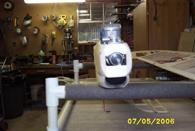

Fellow Contender Owner's:
I finally got around to the cowling. Because I have installed a .60 OS FX, a lot of material had to be removed from the
side pieces. Also, if built according to the plans, I would never be able to remove the engine with out completely tearing it apart
(trashing it) in the event of major engine trouble.
So, I elected to modify it some. The pictures show the finished product. I have screwed (recessed) the two front
blocks on, and the bottom (functional scoop). I will have to cut the covering to access, but that's better than breaking
glue joints. I made a deck or shelf between the functional scoop and the fuselage, so that the air flow is directed
toward the rear of the engine compartment. I fuel proofed the inside of the scoop and painted it black.
The plane is going to be covered in bright yellow with 1" sqs of yellow and black on the bottom of the wing
and control surfaces. I am about read to begin covering the control surfaces. I have used single pcs. of
4-40 rod for each control surface for the plastic DuBro hinges instead of the cotter keys on all control surfaces.
I am going to assy. and balance before I cover with all equipment installed. Laterally and axially.
Wish me luck on the covering. This will be my first complete job. I really think this kit is a bit much
for a first timer. That cowling is a @#*+*.

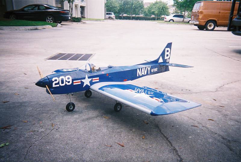

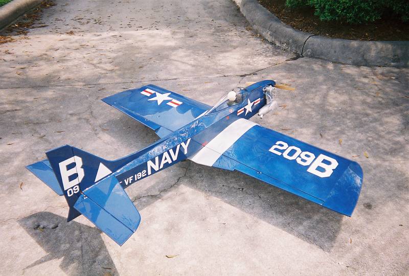

ORIGINAL: spotter
Here's my Contender. O.S. 61 FX. Always thought the Contender looked like a 50's jet. Scheme is the F9F Cougar from the 1954 Korean War movie "The Bridges at Toko Ri"
Stan Potter
Grapevine, Texas
Stan Potter
Grapevine, Texas
Stan,
Brubaker would be proud! Tri gear retracts of course?

Well, Oldtyme, I am not offended. I used the OS .61 because it is the only engine I had on hand and did not want to purchase another. You were right about having to remove a lot of material from the side of the cowling. I finally
figured out a way to build it so I can get in it, later if necessary.
If I had it to do over again, I would probably elect to purchase a .46. I modified the cowling somewhat as you can see in the pics above. I really didn't like the shape of the original. That is just personal preference and no slam intended.
With the .61 in there I could not round off around the spinner like the plans.

#325
ORIGINAL: 8178
Stan,
ORIGINAL: spotter
Stan Potter
Grapevine, Texas
Stan Potter
Grapevine, Texas
Stan,
