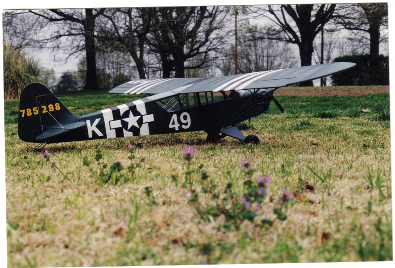

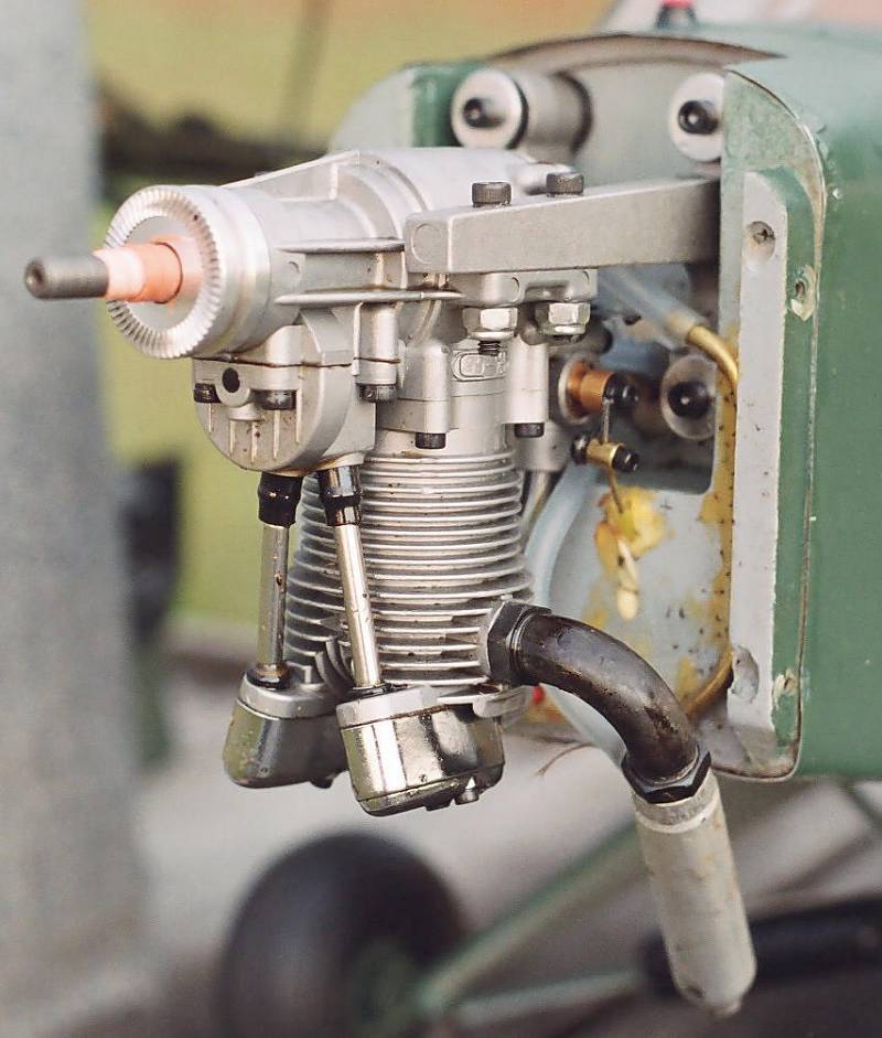

I feel the best of the best is Sig's 1/5 scale kit. Very scale lines, laser cut parts, will fly on a .46 2-stroke, but deserves a .56 to .65 4-stroke. It has a 2-piece wing for easy transport (84.5 inch total span), the struts are functional, comes with a pull-pull setup for the rudder. The landing gear is a solder-it-yourself wire type that has some spring action, but Robart makes a beautiful scale gear for it.
Goldberg and Great Planes also makes Cub kits in that size range, but not quite as nice as the Sig, IMO. Sells for about $140. I built one about two years ago, it was the second kit and first scale model I'd ever built. It was straightforward, the instructions and plans are very clear, and it is a very "modifyable" kit, if you want to change thing to add details. I covered mine in Koverall/dope and put a .65 Saito in it.

I agree, excellent kit.

I also agree. You can't beat the Sig Cub.

wow.... Thats the one(but with yellow trim). That is such a sweet airplane. tell me more about the kit. How easy is it to put together? I only have basic tools and glue to work with. I got 30 min epoxy and thick medium and thin CA. I'm sure I can build it good though. This will also be my first kit. I just love the concept of building a plane then flying it not like thoughs ARF's that you just go to the store and fly, plus you dont have to worry about broken parts or bubbled covering durring transport[8D]
How does the kit fly? from what I watched at the field, It looks pretty good.

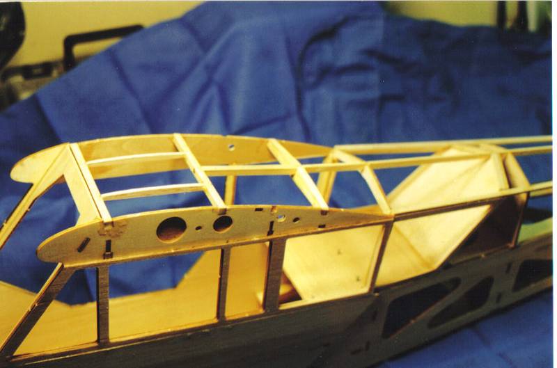

The balsa is all high quality. All the parts are laser cut, and still in the sheet; there is a lot of sticks, plenty of wood left over after the build. Lots of lite ply, hardware package is very good, both in quantity and quality.
The plans are excellent, and the kit is designed to be built on the plans. The instruction manual is very clear, has lots of photos. You can build the plane with a full span or clipped wing, the plans and instructions show both options.
Easy is all relative; if you've done repairs, you should be able to build this plane. It is straightforward, just take your time and be as precise as possible with your cuts. A lot of the cabin and fuse structure will go together without glue, it fits so well; the instructions even recommend this at times, to assemble it dry, square it up and pin it securely, then hit the major joints with Ca, and then go back and get everything else.

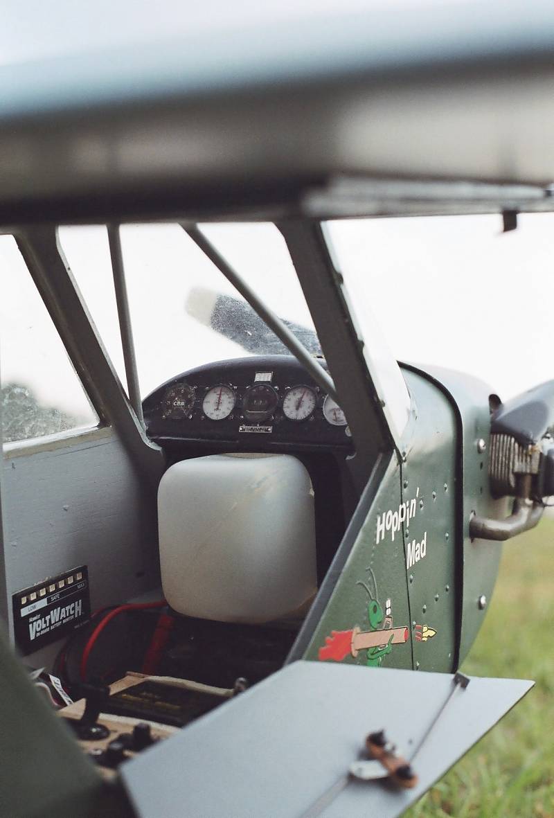

The cabin is very roomy, and the door and window on the right are functional-- they have to be, because that is your access to the radio and servos. The wings have aluminum joiner tubes, so they come off in halves and make for easy transport. The struts are fully functional and the plane CANNOT be flown without them. Each strut attaches to its wing with four 4-40 screws, there is one 8-32 in each wing root, and a 6-32 attaches the strut end to its bracket at the bottom of the fuselage. All the screws fit into blind nuts.
There is a servo tray in the rear of the cabin for the throttle, rudder, and elevator servo, and each aileron has its own servo, which is hidden in the wing and is mounted to an access hatch.

Here's a few pictures that are generic to the kit, showing door detail and the instrument panel, which is included with the kit
