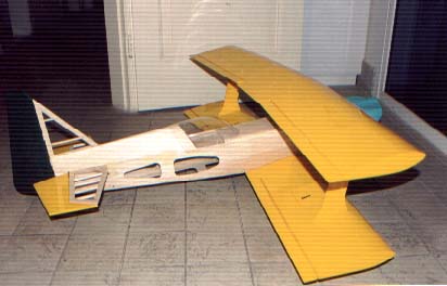

Hisham's Avatar
Posts: 905
From: Beirut, LEBANON
Default mine
buidling is in progress!
Old 11-12-2002 | 09:27 AM
Hisham's Avatar
Posts: 905
Default GP Ultimate Bipe .40
Made a FG cowl and wheel pants!
Dual aileron servos (wells in bottom wings)...
H
