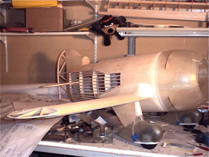

I built the Gee Bee R2 from scratch. My advice with the rudder, Be patient! It takes a lot of sanding and fitting to get it to look right. I highly recommend the fiberglass pants. The gear is going to take a lot of abuse and I doubt that ABS will hold up very well. Hope to have mine flying in the spring.

Well the Rudder is not that bad to build it is just if you are used to more modern kit design the "fall together type" you may have too do a little head scratchin.
Realy it is combo of laser cut AND built up technique the rudder base and ribs are laser cut then you build up from stick stock and shape the area that fits in the rudder "pocket" ( for lack of a better term).
Quite a bit of sanding and fitting is needed but it works great and looks TOO COOL.
I did manage to reengineer the tail wheel set up so it is mounted on the Fuse and still operate off the rudder without any external linkage
I also did an internal pull pull set up on thr elevator also, I just can't figger out how to do an internal set up for the wing sevros.
I did enjoy the kit and is almost ready for silk
Get the Glass pants they sure are nice
